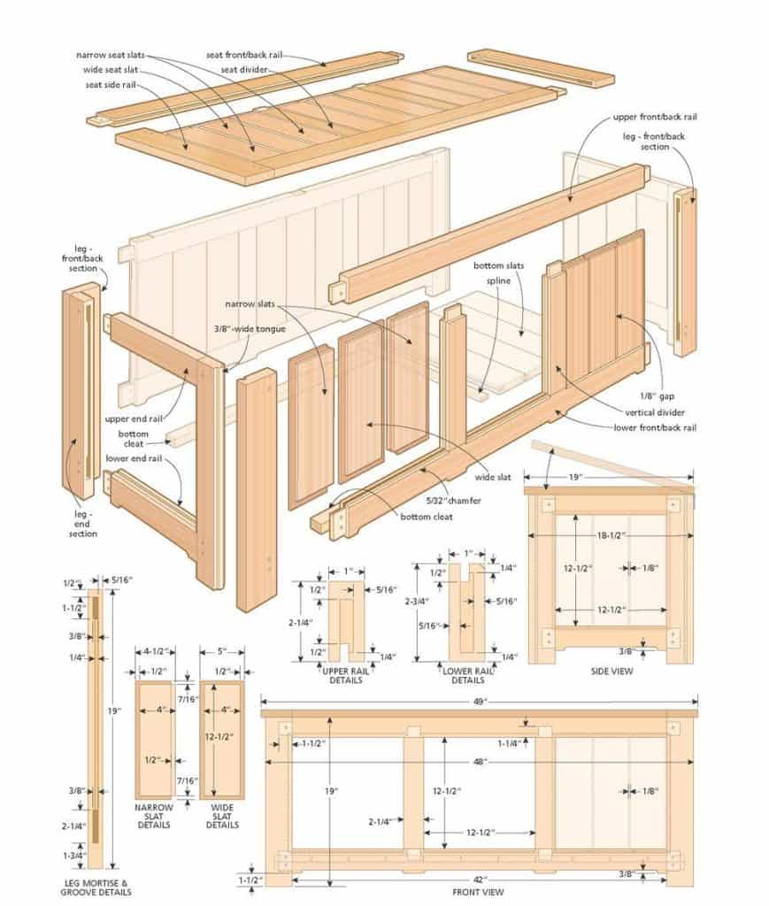

Rough mill all of the lumber
There are more than 60 workpieces in this project so take your time with the layout. As each piece is rough cut to length, mark the end so you don’t lose track later. Many of the pieces are relatively short so I often doubled up the length to reduce the number of pieces I had to run through the jointer and the planer. I like to mill the wood thicker than the final dimension and let it sit until I am ready to use it. If it twists, I can joint the board again before I take it down to its final thickness.
The frame of the box is made from 5/4 stock machined to a finished thickness of 1″. The slats are milled from relatively flat 4/4 stock milled to a finished thickness of 7/8″. This results in the frame being 1/8″ proud of the slats, which adds some interesting shadow lines. If you can’t quite get a full 7/8″ thick from your 4/4 material, dressing it down a bit further isn’t going to cause any problems as long as you adjust for that new thickness when machining the joinery.
The top of the box is milled from 4/4 stock, and I aimed for a finished thickness of about 7/8″. If your 4/4 stock is not very flat, you may have to mill it thinner than 7/8″ which is fine as long as all of the lid pieces are the same thickness.
Build a simple router mortising jig
The frame of this box is held together with mortise and tenon joinery. The rails connect to 3/8″ wide mortises in the legs that are slightly deeper than 1-1/2″. My longest 3/8″ spiral router bit can rout that deep, but only if the router is sitting directly on the workpiece. If you’re careful, you can rout the mortises using an edge guide, but I prefer a wider and more stable platform to keep the router flat on the edge of the workpiece.
To make such a platform, I glued and screwed two pieces of MDF to some thick pieces of maple that I clamped on opposite faces of the workpiece. The router base sits on top of the MDF and slides against a wooden fence. The fence must be parallel with the front of the jig and offset so the mortise is 5/16″ from the edge of the workpiece. Make one or more test cuts to dial in the fence position, noting the 5/16″ offset is not critical as long as the mortise is parallel with the edge of the workpiece. For a little more stability, a second fence can be added to keep the router tight against the primary fence.
Machine the legs
Each leg consists of two pieces of 19″ long stock joined with a 3/8″ wide tongue and matching slot. This joint doesn’t add any strength to the leg, but it keeps the two pieces aligned when the box is glued together. Rout the slot on the router table, locating it so the tongue will be centered on the mating piece. When the two pieces are joined, they should each be 3″ across. It’s possible to join the two pieces that make up each of the four legs with bevel joints so the joint is less visible.
Lay the legs out to form a box using the 3″ wide pieces (the ones with the routed slots) for the front and back of the box. Mark the top of each piece and lay out the mortises. The bottom mortise starts 1-3/4″ from the bottom of the leg and is 2-1/4″ long. The top mortise starts 1/2″ from the top of the leg and is 1-1/2″ long. Mark the inside face of each leg piece to use as the reference face for the joinery. This will ensure the slats are flush with the inside of the box and therefore recessed from the front. Rout all of the mortises to a depth of just over 1-1/2″.
Set up your router table with a 1/4″ slot cutting bit positioned so the bottom of the cutter is 5/16″ above the surface of the table. Use a test piece to confirm the bit height and to adjust your fence to cut a slot 1/2″ deep. If possible, you will want to leave this router setup in place to rout all of the slots in the frame pieces as well as the slats. Start with the legs and rout a slot between the mortises. Be sure to have the inside face of each piece against the router table.
Drawbored mortise and tenons
The rails connect to the legs using 1-1/2″ deep tenons that are drawbored for extra strength and to simplify the assembly. There are many ways to cut the tenons. I chose to use my table saw to form the shoulders and my band saw to cut the cheeks. Start by cutting the rails to length – 15-1/2″ for the short rails and 45″ for the long rails. Lower your blade to just over 5/16″ and adjust your fence (and optionally a small stop block) so the left side of the blade will cut exactly 1-1/2″ from the end of the wood. Start with a test piece and then cut all four faces which define the shoulders for the tenons. If your fence is not perpendicular to the table or is not parallel with your blade, the shoulders may not line up. If this happens, try referencing instead off a small 1-2-3 machinist block pushed against the fence. When you are satisfied with the setup, make the same four cuts on the end of each rail.
To cut the cheeks, move to your band saw. Set the fence to cut away the cheeks, leaving the tenons slightly thick so they can be cleaned up with a shoulder plane. Round-over the tenon to match the ends of the mortise. You’ll need to fine-tune the fit with a chisel to ensure the joint seats properly and fully. Confirm that the shoulders are square to the rails so the frame will be square when the drawbored pegs are installed.
Use a 7/32″ brad point bit to drill the holes for the drawbored pegs. Start with the legs and be sure to remove the rails since the tenons are marked and drilled in the next step. The bottom mortises have a pair of pegs and the narrower top mortises have a single peg.
Dry fit the rails into the legs and pare the tenons as needed so the top rail is flush with the top of each leg and the bottom rail is 1-1/2″ from the bottom of each leg. Use clamps if needed to ensure the tenons are fully seated in the mortises. Using the same 7/32″ brad point bit, transfer the center of each hole to the tenon and then disassemble the frame. If you drilled holes through the tenons using these center points, you would have a pegged mortise and tenon joint. To drawbore the joint, you need to slightly offset the hole towards the shoulder of the tenon.
Complete the rails and dividers
The front and back of the deck box each have two vertical dividers that are mortised into the rails. The mortises are 1-1/2″ long and slightly over 1-1/4″ deep. Start by cutting the four dividers to a length of 15″. Referencing the inside face of each piece, follow the same procedure as before to machine the mortises in the rails and matching tenons on the dividers. Use the slot cutter bit setup in your router table to cut 1/4″ wide grooves on both sides of the dividers and the inside edges of the top and bottom rails.
The four bottom rails have a decorative cutout that’s rough cut with the band saw and flush trimmed with a template and a pattern bit in your router table. The final step with the bottom rails is to machine a small chamfer where the slats meet the rail to promote water runoff. The chamfer runs the full length of the short rails and is stopped where the dividers join the bottom rail. You may want to defer these last two routing steps until the slats are completed, since they will use the same slot cutting bit setup as the frame pieces.
Tongue and groove slats
Each panel in the deck box consists of three slats joined with a tongue and groove on all four sides. To allow for seasonal variations in the slat width, there is a 1/8″ gap between the slats. No gap is needed on the top and bottom; the slats can butt tightly against the rails. Each slat is 4″ wide, excluding the 1/2″ wide tongue portion. One slat per panel has a tongue all the way around the perimeter so this board needs to be cut 5″ wide. These are the center slats. The other two slats are cut 4-1/2″ wide since they have a tongue on the top, bottom and only one side; the opposite side has a matching slot. The length of each slat should be about 7/8″ more than the 12-1/2″ distance between the rails. When the shoulders are cut, the slats should fit snugly between the rails.
Using the same slot cutter setup as before, rout the 1/2″ deep slots in one side of the 4-1/2″ wide slats, keeping the inside face against the router table. To rout the tongues along the length of the slats, switch to a rabbeting bit and set the height so the top of the cutter is 5/16″ above the table and the rabbet depth is 1/2″ deep. Use a test piece the same thickness as the slats to dial in the fit. If the slats are not exactly 7/8″ thick, or your slot cutter is not exactly 1/4″ wide, you may need to remove different amounts of wood from opposite faces of the slats. You could raise and lower the rabbeting bit when switching sides, but I find it easier to use a shim between the slat and the router table for the face that needs less wood removed. Use veneer or several layers of paper. Even a few strips of masking tape can quickly act as a shim. To get a clean cut, you may want to rout the rabbets in several passes to get the full 1/2″ depth.
To machine the tongues on each end of the slats, use the same table saw and band saw setup when the tenons were cut. This will give a cleaner and more consistent shoulder. Follow up with the shoulder plane to clean up the face of the tongues so they fit in the grooves in the rails.
Glue up in stages
Be sure to use an exterior adhesive for the assembly of this project, as the elements will cause a non-exterior grade adhesive to fail. With all this careful machining, the last thing you want to do is watch your deck box fall apart over the span of a few months. A waterproof epoxy is the option I went with, though a Type-II or Type-III PVA adhesive would also work well outdoors. Every adhesive has its strengths and weaknesses, so make sure you know the characteristics of the adhesive you’re using before assembling a project.
There are too many pieces to glue the deck box together at one time, so I glue it up in stages. I started with the end panels before moving on to the front and back. Dry fit the pieces so you can work out an even spacing between the slats. I used some thin offcuts and built up to the required spacer thickness with a few layers of blue tape. The slats are glued into the rails, but only use glue over the center inch to allow them to expand and contract with the seasons. No glue is used between the slats or where the slats join the legs or the dividers.
While the glue is drying, follow the same steps to make the top of the box. Adjust the mortise offset to account for the thinner stock. Rout the slots so the slats are flush with the top of the lid so it can be used as a seat.

Illustration by Len Churchill
