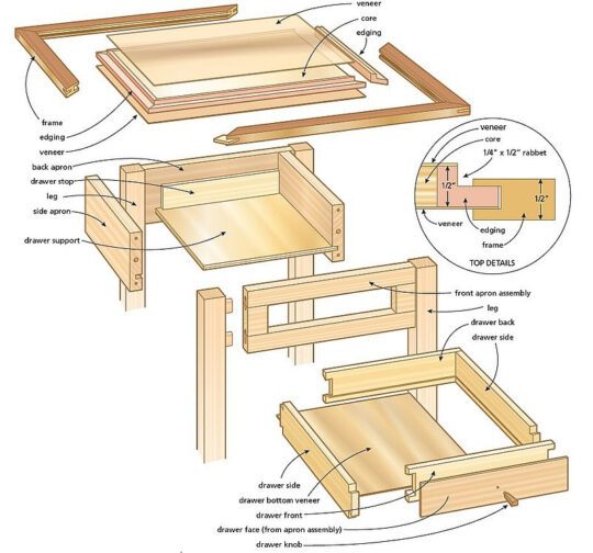

Next, create a rabbet on the edge that’s 1/2″ deep by 1/4″ thick. Part of this rabbet will fit into a 1/4″ groove in the frame for the tabletop. To help eliminate the risk of tear-out, use strips of blue masking tape along the edge of the top. I also put a couple of strips in the middle to stop the face veneer getting scratched as I slide it along the router table. Firmly push down the blue tape with a round-faced hammer. Take small incremental cuts until you reach the desired profile.
To frame the top, I chose some wenge. I felt it complemented the colours of the veneer. I milled up a piece that was 56″ × 1″ × 1/2″. Since we want the panel to stand slightly proud of the frame, cut a groove in the frame pieces 3/8″ deep and 1/4″ wide. This groove starts 1/8″ from the top face of the frame. Check the actual fit of the piece using the rabbeted top and adjust as necessary. Cut the miters on the frame pieces and test fit everything. In the end we want the rabbet to protrude into the groove about 1/4″ and leave 3/16″ to 1/4″ of reveal around the top.

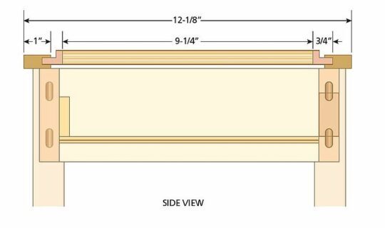

While this piece is not going to see a lot of traffic, I thought it was a good idea to strengthen the miters for the top with splines. You can use a commercial jig for this, but it took very little time to make a plywood version. There are times when I will use a contrasting colour for mitre splines, but in this case, I didn’t want to add any new colours or visual distractions. Glue them in and trim them flush when cured.

I chose to add a slim drawer to the stand to hold my scissors and training wire for the plant. I opted for a single tail dovetailed drawer, however there is more than one way to complete this, including rabbeted and pinned as well as drawer-lock router bits.
For the drawer bottom I decided to use some beautiful kingwood veneer. I used the same process as above, however I veneered over 1/8″ Baltic birch. There’s no need for edging on this panel because it gets buried into the groove that we will create next. Press a panel slightly larger than what’s needed; in this case approximately 10-1/2″ × 8-1/2″.
I’ve found one of the easiest ways of putting in a drawer bottom is to use a box slotting bit. Dry assemble the drawer and run the bit along the inside of the drawer. This bit from Lee Valley Tools comes in two different diameters and thicknesses. The sets come with a pair of bearings allowing you to cut different depth slots. Before cutting the slot, sand the panel for the bottom, bringing it closer to its final thickness. Creep up on the final size by using a scrap piece of wood to test that the panel fits the groove nicely. Use the bearing in the set that makes a 3/16″ deep groove. Since the router bit leaves rounded corners, I used a wheel gauge (a washer also works) to pencil in, then cut and file, the corners of the panel. Glue and clamp as you would for any other drawer. The drawer will need to be hand planed near the end to ensure a good fit in its opening.

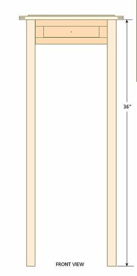

Be careful milling up the pieces for the aprons and legs, as they all come from one slightly larger piece of wood. The front apron needs to be at least 1/4″ wider and longer than the listed final size. The reason being is we are going to make two rip and two crosscuts to remove the piece that will become our false drawer front. The drawer face is 8″ wide by 1-5/8″ deep. After cutting it out, carefully glue the remaining pieces to re-form the front apron. Cut the remaining aprons to their listed sizes. The approach of cutting the drawer front from a panel, and having the top, bottom and side sections come from that same panel, works best if you start with a simple, straight-grained workpiece. This ensures the grain is almost invisible in the final piece.
For the joinery on the front and rear aprons to legs, I chose Festool Dominos, however, you could use different strategies here including mortise and tenons, dowel joints or biscuits. Pick the method you’re comfortable with and have the tools for. The aprons that join the front and rear also act as drawer runners. I chose dowel joinery for this pair as it needed to fit in between the previously installed Dominos. Take a look at the article on dowel joinery in the Feb/Mar 2014 issue to make your own shop-made solution. To complete the apron-to-leg joinery I used a pair of 6mm × 40mm Dominos. To join the side aprons to the front and back I used 1/8″ and 1/4″ diameter dowels, both 1″ long. Make the holes for the dowels slightly deeper than 1/2″ in corresponding pieces.
Dry fit the aprons to each other and mark the location of the bottom of the drawer opening on the side apron/runners. Cut full length 3/8″ deep grooves to accept the 1/4″ thick Baltic birch drawer support.

To attach the top to the bottom carcass, I used figure eight connectors mortised with a 11/16″ Forstner bit on top of the legs. Use #5 × 5/8″ flat head wood screws to secure them. These connectors aren’t quite meant to be used in this fashion, however, they still worked perfectly fine. I cut up 1/2″ diameter dowels to take up the space between the connector and the bottom of the top. Be careful when driving the screws into the top. If you’ve modified the size, take care to use the right length of screw.
