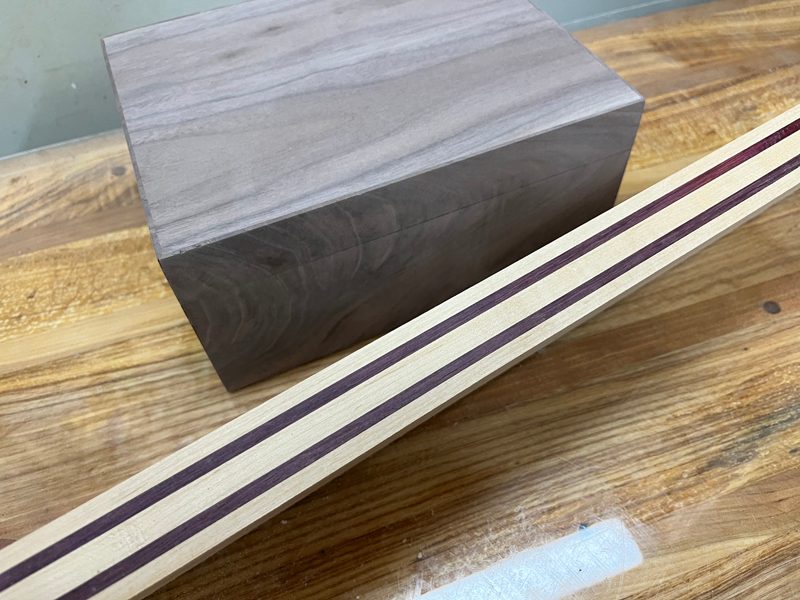

Start by resawing thin layers of contrasting wood to create a laminated blank for all these parts. I used maple for the outside layers and centre core, with two thin layers of purpleheart sandwiched in between. I made all my outer layers about 3/16” thick and the centre core roughly 3/8” thick, resulting in an overall thickness of 1-1/8”. This is just a general guideline, so feel free to choose materials and a layering configuration that works best for your design. My laminated blank ended up being 5” wide and 24” long, more than enough for all the parts I would need, with a little extra for second attempts.

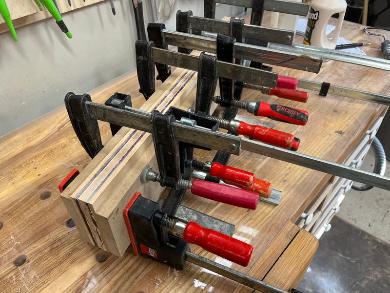

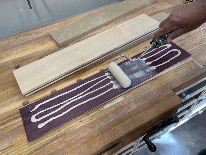

To assemble the lamination, I applied an even coat of glue to the mating faces with a foam roller before clamping the layers together with just about every clamp I own. To achieve even pressure in the centre, I used wood culls between the clamps and lamination to distribute the load. Your objective is a good bond with all the surfaces and no visible gaps between the layers.

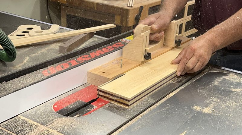

After letting the glue cure overnight, remove the clamps and clean up the edges at the jointer. Next, rip two or three 1/8” thick strips from the edge of the blank to create a supply of flat ribbon that will be applied to the top and sides of the box. I cut my strips at the table saw using a thin-strip ripping jig. Another alternative is to position the fence so the thin material drops to the outside of the blade, though this technique requires that you accurately reposition the fence after each cut. What you should not attempt is to rip the strips on the fence side, with the fence positioned 1/8” from the blade. This is a recipe for dangerous kickback, which could cause the strip to fire back at you like a missile.

Once the contrasting bow layers are machined, apply glue to their surfaces and clamp them up.
Cauls to the Rescue
Using cauls while gluing up the lamination layers will not only spread out the clamping pressure, but also help keep the assembly flat.

Thin Strips
Campbell uses a special jig to help him rip thin strips from the lamination. Another safe approach is to keep the main portion of the workpiece between the fence and blade and adjust the fence to leave you with an offcut the thickness you need.
