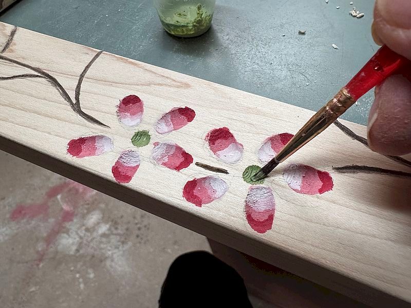

I’ve used milk paint on many projects before, and I really like it. I mixed up some pink and started colouring all the flower petals. The plan was to colour the majority of each petal pink, then add some red towards the ends of each petal. The vines would be painted dark brown and the centre of each flower would be painted green.
Once I wrapped up all the pink and red I stood back. It was a bold look. Very bold! Next up, dark brown. It went on a bit tediously, but I got the job done. I sent a photo to my wife and told her, “I might have gone too far with this.” Either way, what was done, was done.

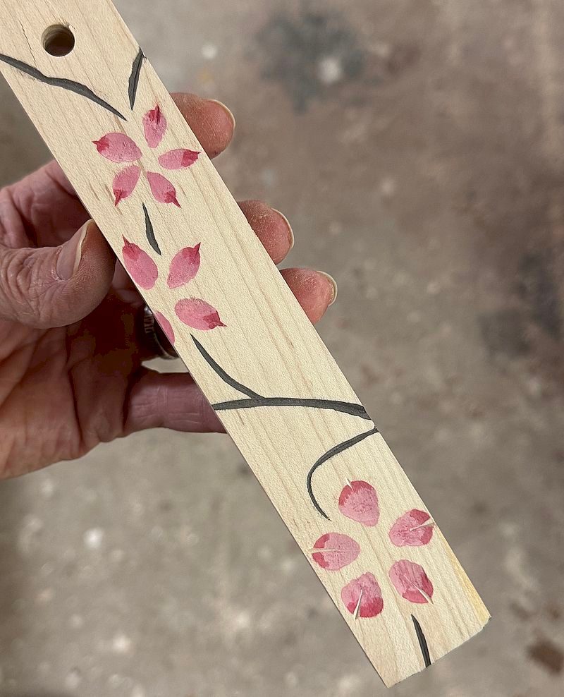

Small Sample
I made this tiny sample, mainly to show my wife my idea. It also allowed me to check out how well the carving / painting effect worked.

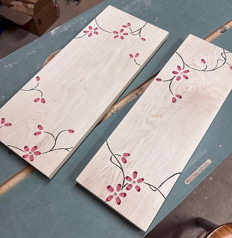

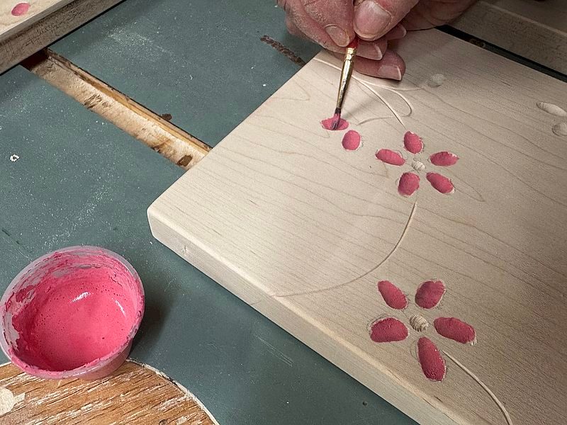

First Colour
Pink was applied first. I didn't worry about getting it all the way out to the tip of each petal, as the red was going to cover those areas. I also didn't worry too much about getting small amounts of paint on the main faces of the project, as I knew I could sand off any errant paint later.

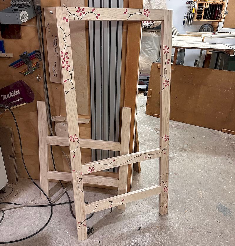

The Main Frame
Here's the main section of the step stool, with all the flowers and vines on it. Striking, for sure. Maybe too much so!

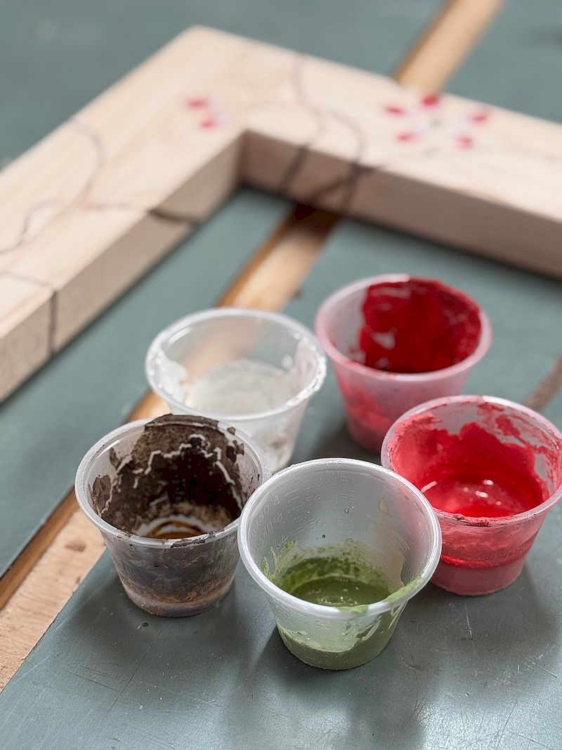

Leftovers
Here are the small batches of colours I mixed up, with the nearly finished frame behind them.
