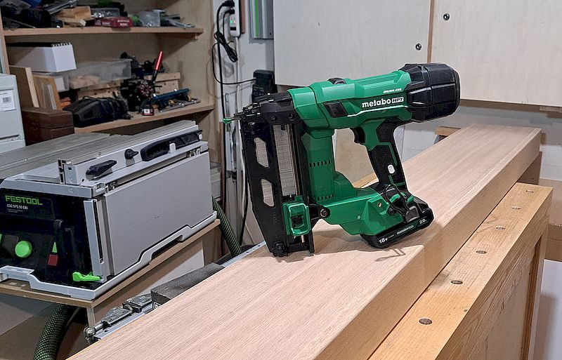

Light weight and good balance are two key features I look for in any hand tool — and the Metabo 16-gauge straight finish nailer nails both. Weighing just 5.7 pounds, it’s one of the lightest in its class. With the included 2.0Ah battery the total weight comes to just over 6.5 pounds, still light enough for extended use without putting undue strain on your arms or shoulders — especially when working overhead. That same 2.0Ah battery will drive up to 800 nails on a single charge. For longer runtime, you can upgrade to a higher amp-hour battery pack.
Metabo NT1865DSA

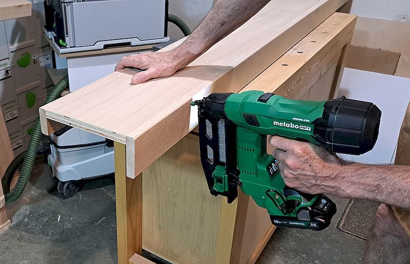

Slim design and light weigh make this nailer easy to handle

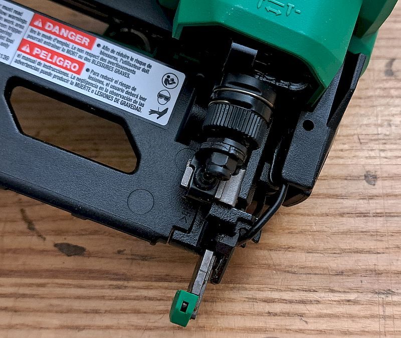

One of the nailer’s standout features is its reliable driving power. It consistently sinks nails flush, even into hardwoods, even with the longer 2-1/2″ fasteners. Once you’ve dialed in the depth adjustment, you rarely need to touch it again unless you switch to a different nail length or wood density.
Metabo NT1865DSA
Turn the knob to set nail depth and then forget about it

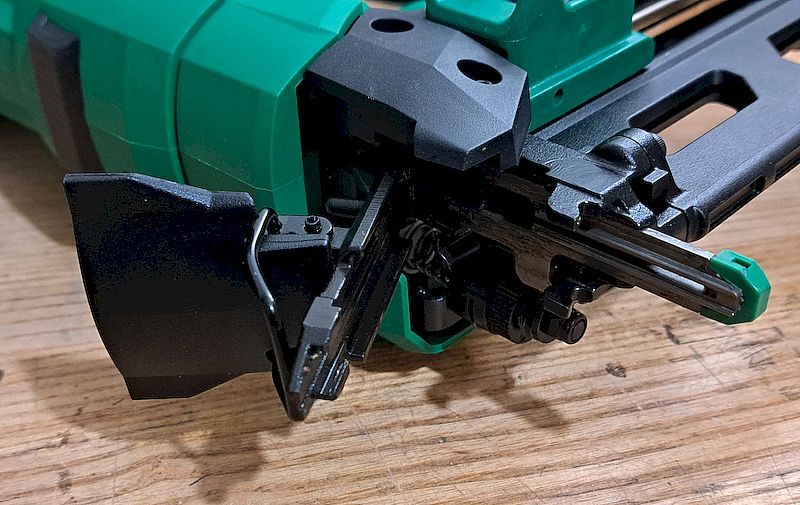

I haven’t run into any jams yet, but if one occurs, the flip-open nose release makes clearing it quick and easy.
Metabo NT1865DSA
Flip the latch, clear the jam, back to work

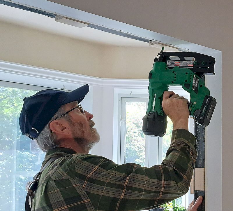

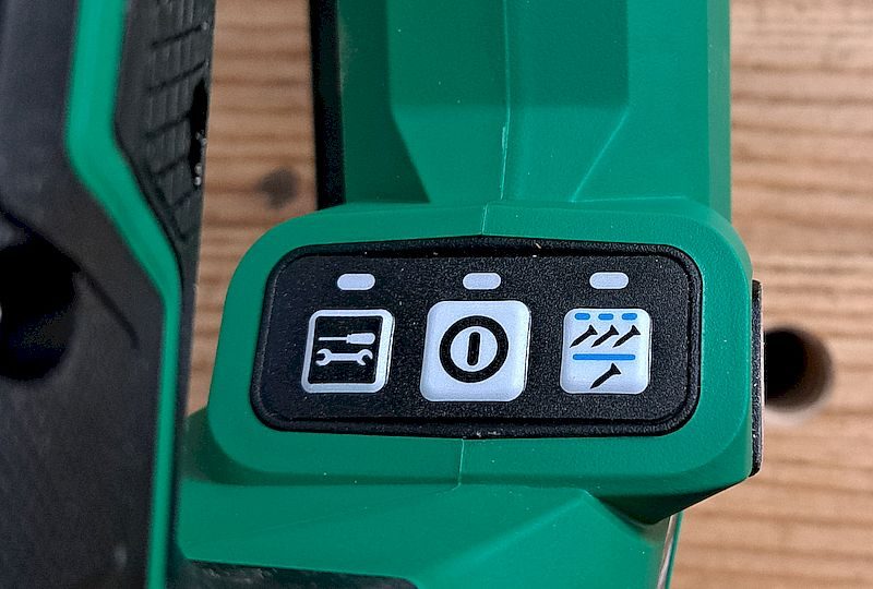

I mostly use trigger fire, but for those times I want to switch to bump firing, all it takes is the press of a button on the control panel—simple and intuitive. The power on/off button is also conveniently located on the control panel, along an information icon that changes colour to indicate low battery or when the tool is overheating.
Metabo NT1865DSA
Convenient push button control panel

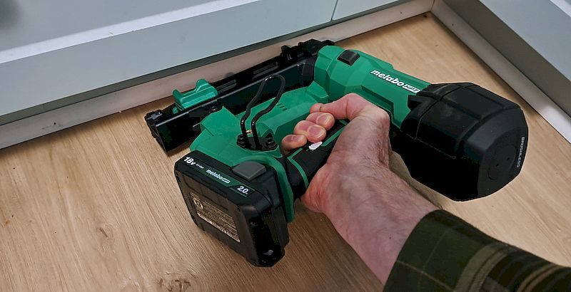

The slim nose design is another big plus. It allows for better visibility and reach into corners, making it easier to place nails precisely. I can place nails just under 1″ from a wall or adjoining surface — great when working in tight quarters.

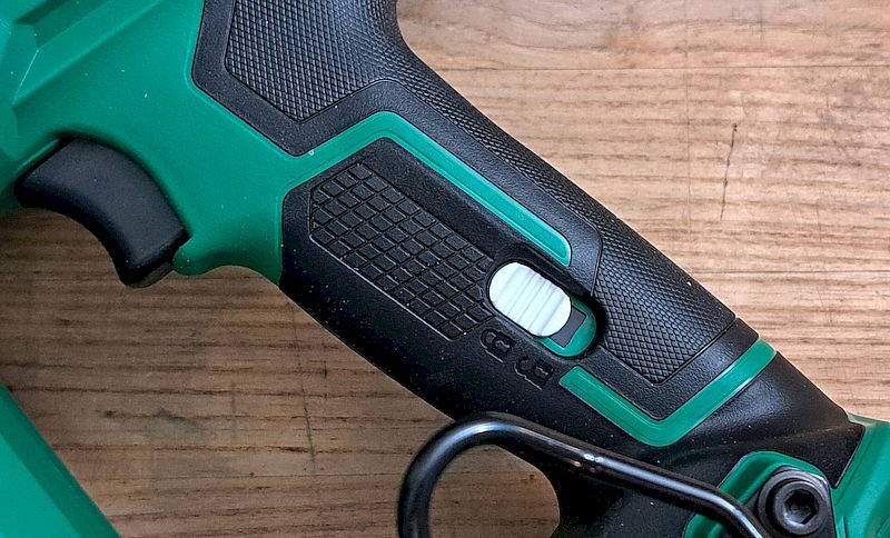

Trigger lock prevents accidental firing
