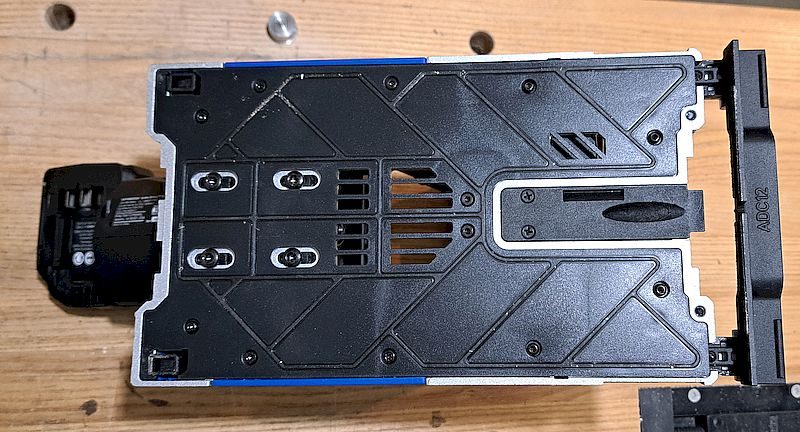

- A metal frame, integrated dust collection (with a bin and a vacuum hose option), a non-slip GripMaxx base, and a narrow rail guide for working with slimmer material.

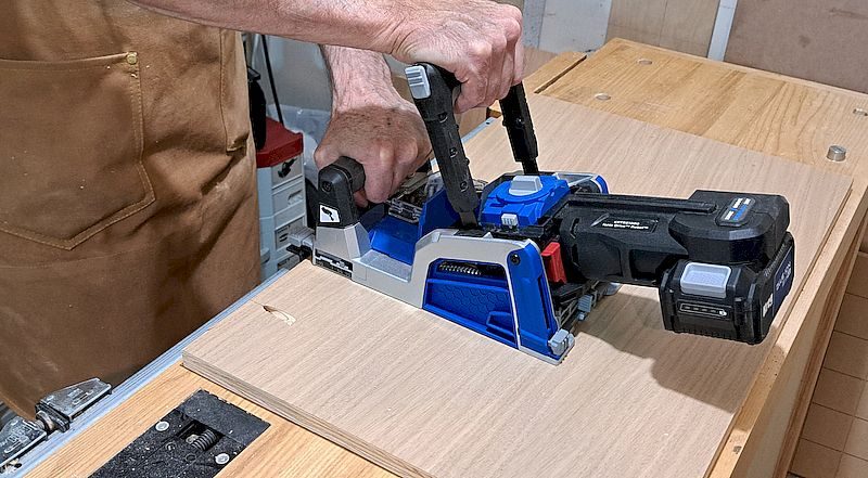

With a standard pocket-hole jig, you typically dial in the thickness, clamp the material, drill with a separate drill, maybe switch bits, reposition for the second piece, and so on. With the Rebel, you set it once and drill — no extra drill required. I find setup noticeably faster, which is a real benefit when doing repeat holes or small production runs.
One of the biggest advantages for me is that the Rebel is cordless and portable, so I can bring it to the material instead of dragging awkward panels to a bench jig. That pays off when I’m working with large or heavy material, or when I’m installing cabinetry onsite.

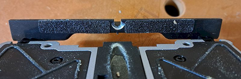

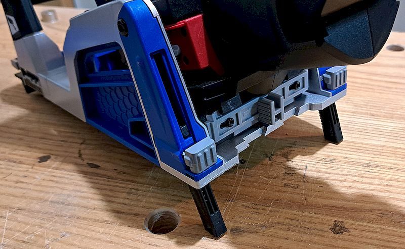

In many cases, I don’t even need to clamp the material. The GripMaxx base (which has an array of narrow anti-slip ribs) and support feet hold the material surprisingly well. The anti-slip face on the fence also helps keep things steady. That said, for irregular material or when I need absolute precision, I’ll still use clamps. And no matter what, it’s important to apply firm downward pressure on the front handle — skip that and the bit can skate across the surface.

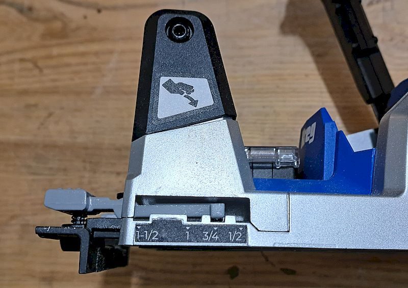

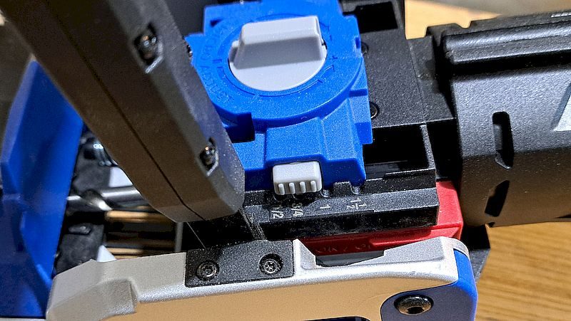

Setting up the Rebel is straightforward. A lever beneath the front handle sets the material thickness (from 1/2″ to 1-1/2″). On top, you’ll find the drilling depth stop and micro-adjust dial. When drilling into 3/4″ material, I simply match both the material setting and depth stop to 3/4″. That keeps the bit from fully breaking through.
Kreg also includes a narrow rail guide for securely drilling into slim material up to 4″ wide. You need to be a tad careful when drilling into narrow material — around 1-1/2″ and narrower — to ensure that the Rebel doesn’t rock from one side to the other as it rests on the material.

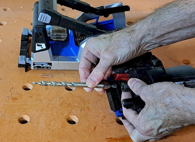

Eventually, you’ll need to replace the drill bit. Swapping it out is quick and tool-free — just remove the motor unit and slip in the new bit.

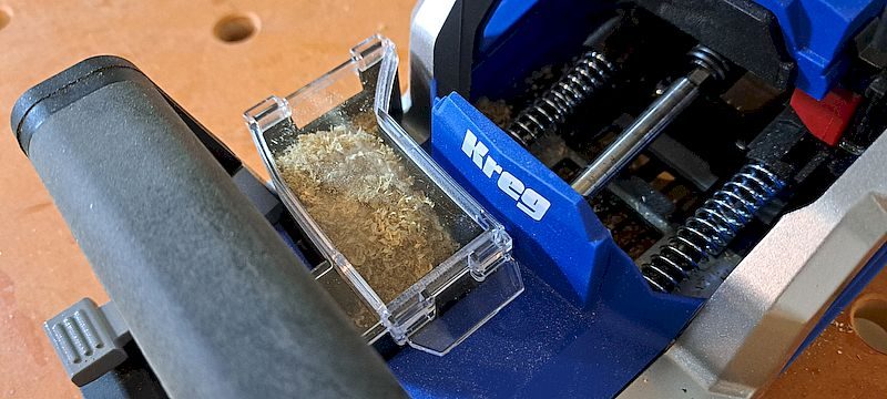

Pocket-hole drilling doesn’t create nearly as much dust as sanding or routing, but I still get better visibility (and a cleaner shop) by using a vacuum hose. The onboard dust bin fills after about a dozen holes, and debris starts spilling onto the work surface. The vacuum port doesn’t match Festool or Bosch hoses directly, so, like me, you may need an adapter.

- Empty the dust bin often — chip build-up can throw off accuracy.

- When joining mixed materials (like plywood to solid wood), use the micro-adjust to fine-tune bit depth.
