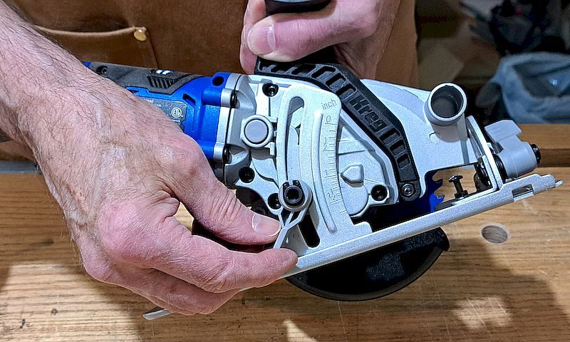

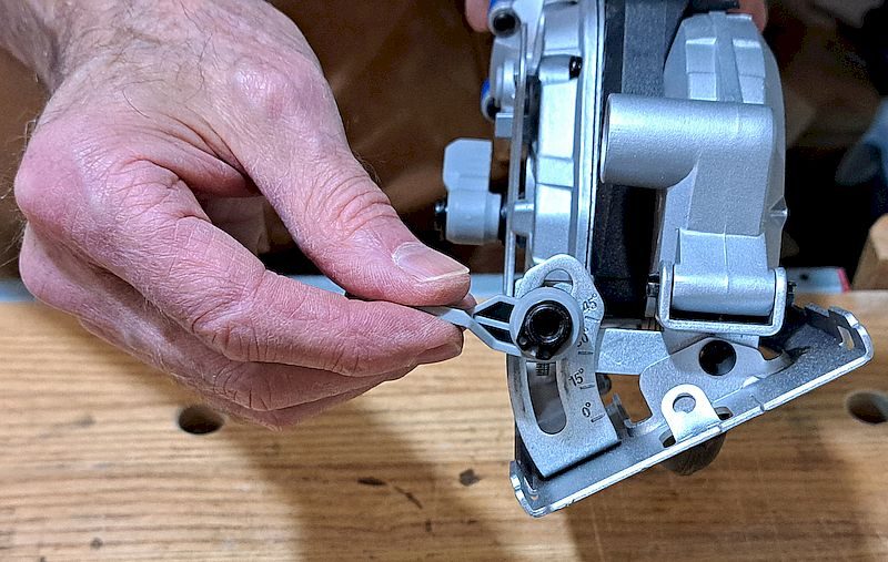

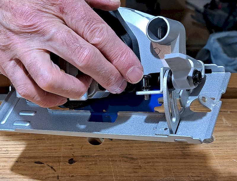

I found it quick and easy to make blade height and bevel angle adjustments, thanks to large, easy-to-grasp adjustment knobs. Once tightened everything stays firmly in place. There is a small screw on the side of the bevel adjuster that lets you set the blade exactly at 90° to the base.

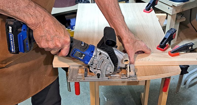

In use, the Ionic Drive 4-1/2″ feels noticeably lighter and more nimble than a full-size 7-1/4″ saw, which makes it easier to control for short crosscuts, bevels, and working near finished surfaces; that smaller footprint also helps when working inside cabinets or on ladders.

Quick and easy depth adjustment.

Same goes for the bevel adjustment.

This screw enables you to set the blade square to base.

Well-balanced, easy to use, and with the right blade gives clean cuts.
