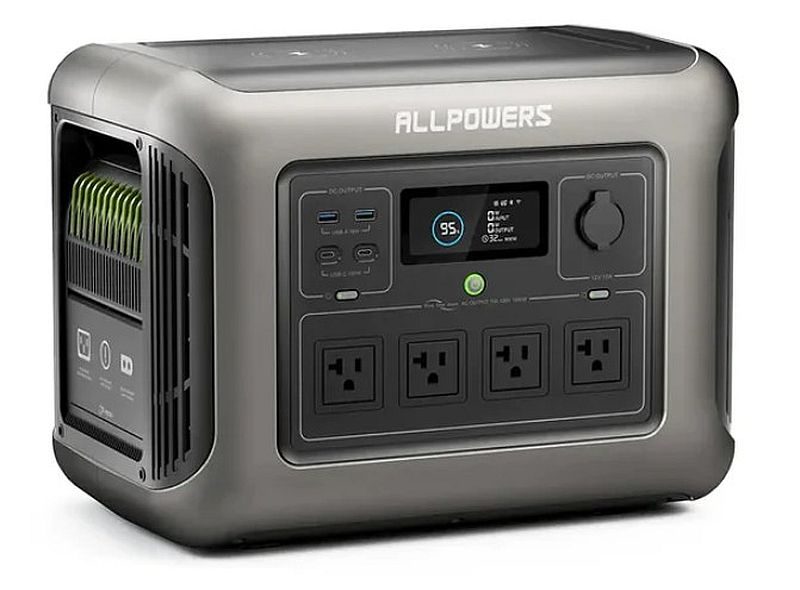

KEY FEATURES:
  • Capacity: 1152Wh / 24000mAh
  • Battery type: LiFiP04
  • AC output: 4x 100-120V, 1800W Max (Surged 3000W)
  • Ports: USB-C Port 2x 5/9/15V⎓3A, 20V⎓5A, 200W Max;
    USB-A Port 2x 5V⎓3A, 9V⎓2A, 12V⎓1.5A, 36W Max.
    CAR Port 12V⎓10A, 120W Max.
  • AC input: 100-120V 6.8A Max
  • Solar input: 12-60V 13A, 650W Max
  • Car input: 12V/24V DC
  • Wireless charger: 2*30W Max
  • Dimensions: 16-1/4″ x 12-1/4″ x 10-3/8″
  • Weight: 36.8lbs.
  • App connection: Wi-Fi / Bluetooth
  • Warranty: 5 years

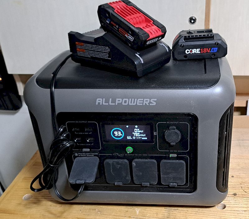

One of the more capable options I’ve come across is the ALLPOWERS R1500 Portable Power Station. It delivers up to 1800 watts of continuous power from a 1152Wh LiFePO4 battery, known for its exceptional lifespan and stability. In practical terms, that’s enough to keep a fridge, sump pump, router, or a selection of shop tools running for several hours.
You may not have heard of LiFePO4 batteries before. LiFePO4 stands for lithium iron phosphate, and it’s become increasingly popular thanks to its reputation for safety, stability and long service life. These batteries can typically handle 3,000 to 5,000 charge cycles before their capacity begins to decline — several times more than standard lithium-ion or lead-acid batteries. Another advantage is their consistent power delivery: they maintain steady voltage through most of their discharge cycle, so tools and devices perform reliably until the battery is nearly depleted.
The R1500 features a pure sine wave inverter, which converts DC (direct current) from the battery into AC (alternating current) that closely replicates the smooth, sinusoidal waveform from the electrical grid. Many cheaper units use a “modified sine wave” or “quasi-sine” design — a rougher, stepped waveform that can cause issues with sensitive electronics. Because of its pure sine output, the R1500 is safe to use with computers, audio gear, medical devices and variable-speed motors.
I also like that the R1500 can be recharged in multiple ways — from a wall outlet, vehicle, or solar panels — making it handy not just for emergencies but also for camping, outdoor projects, or remote work. ALLPOWERS offers a range of compatible accessories, including a reasonably priced 200W solar panel that integrates seamlessly with the system.

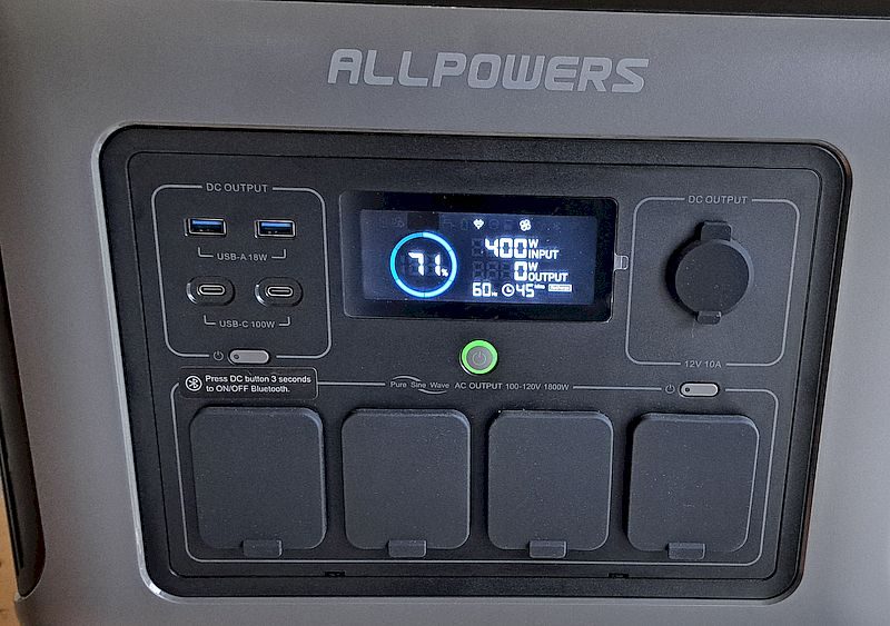

Another standout feature is its fast recharge time. Based on my experience, you can expect a 0–80% charge in under an hour from a wall outlet, and a full charge in roughly 1.5 to 2 hours. The built-in display provides clear, real-time information about input/output wattage, battery level, and remaining runtime, so there’s no guesswork. It also includes Wi-Fi and Bluetooth connectivity, letting you monitor and control the unit through an app — something I’ve found surprisingly useful for checking its status from across the shop. Yet another cool feature is that the R1500 includes two wireless charger pads (30W max each) on the top surface for charging compatible phones, earbuds or other Qi-enabled devices.
One of the R1500’s biggest advantages is that it’s compatible with expansion batteries. This lets you dramatically extend runtime — perfect for keeping appliances, lights, or power tools running longer during outages or off-grid use. The additional capacity gives you more flexibility to run multiple devices at once without worrying as much about draining the system too quickly. It’s worth noting that while expansion batteries increase energy storage, they don’t raise the R1500’s inverter limit — the maximum continuous output remains 1800 watts.
At just under 37 lbs, the R1500 isn’t the lightest power station around, but its capacity, versatility, and output more than make up for the extra weight. It can be used outdoors if the weather cooperates, though it’s not waterproof, so it’s best kept under cover.
While traditional gas generators still make sense for long-term or high-demand use, a power station like the ALLPOWERS R1500 fills an increasingly important niche. It’s quiet, clean, maintenance-free, and highly adaptable — ideal for anyone who wants reliable backup power without the noise, fumes, or upkeep of a gas engine. Whether you’re running a small workshop or simply want peace of mind during power outages, the R1500 makes portable backup power both practical and convenient.

Easy to read, informative display – nicely laid out array of output ports.
