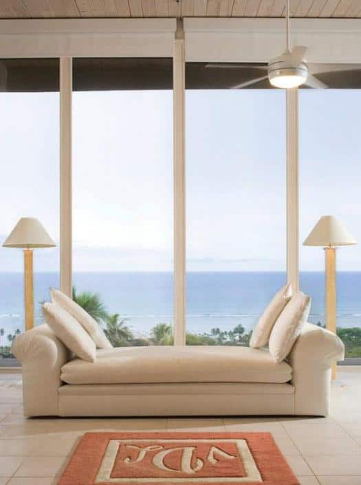

Reduce the Temperature
In locations where the sun’s rays will make cooling a room difficult, special window film can help keep solar radiation out.
Big Difference
The windows on the left side of this photo are shown without window film. The windows on the right have film, and are less bright and show less glare, making it more comfortable for people to be in the room on a sunny day.
