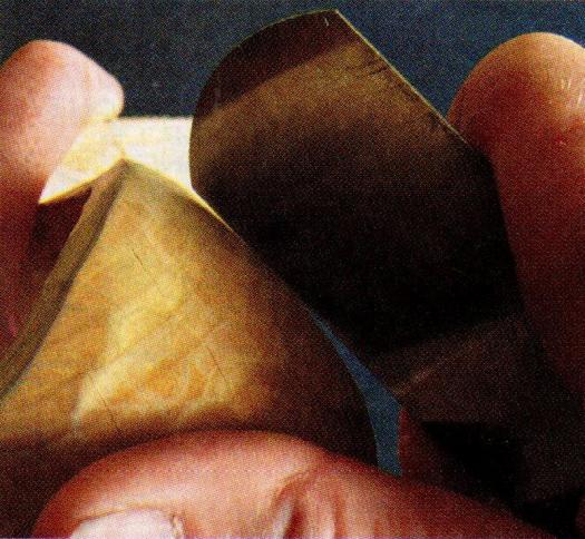

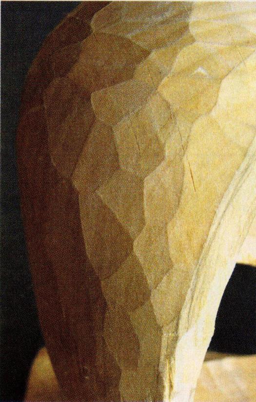

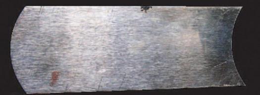

However, I have found a two-part solution to this distasteful task. The first half of the secret is a wood scraper. Major ridges can be removed very quickly with a scraper, as they act essentially like a hand plane. When you have shaped your carving as carefully as you desire with your gouges and knives, use a scraper to smooth the surface. It is imperative that you scrape with the grain.

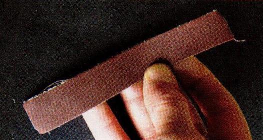

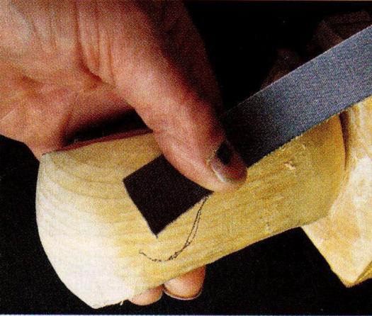

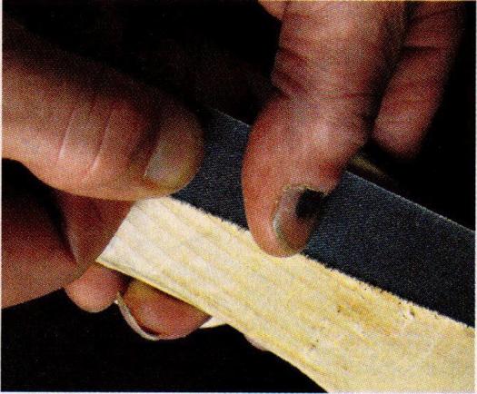

After scraping, I use strips of cloth-backed sandpaper. Press the sandpaper against the wood with one thumb. Using your other hand, pull the sandpaper across the wood under your thumb. It is important to sand with the grain and in only one direction. This technique eliminates the ‘fuzzing’ that always occurs when you rub sandpaper back and forth across wood grain. Sanding this way is very fast. When you sand in only one direction (with the grain), the task can be completed in minutes instead of hours.

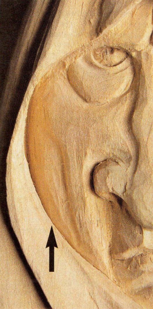

How To Carve Deep Crevices?

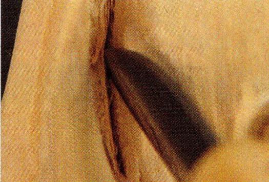

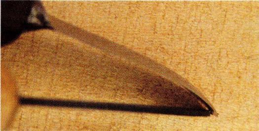

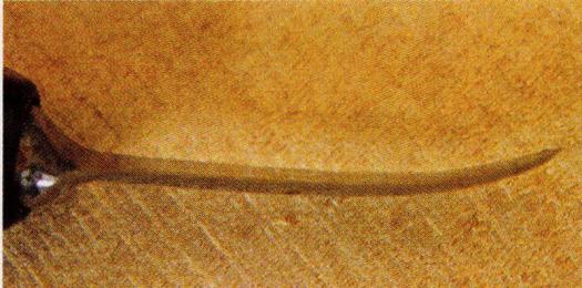

When carving a deep crevice, many people have difficulty removing the deepest chips of wood. The solution is all in the angles of cuts… and a little patience. First, it is necessary to make a strong vertical cut that will provide an edge from which wood will be removed. Then, use a curved tip knife to cut away the wood beside the vertical cut. The bent tip creates a slightly less acute angle deep in the crack.

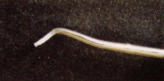

It is most important that you make a good effort to remove the wood chip. Often, a carver will shave off several new slices of wood when trying to remove a piece that is already detached. To extract difficult slices, a dental tool can be quite useful. Many dentists will give you the tools they are discarding.

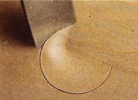

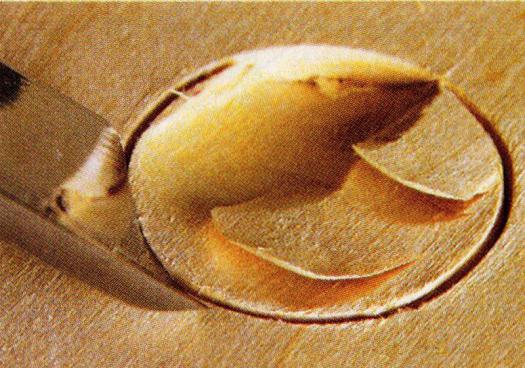

How to Carve a Hole?
There are many situations where you need to carve a hole, either to start a pass through for further expansion, or to create a hole for itself. In many instances, a power drill or a brace and bit will work. In other cases, however, it is simply easier to use a gouge. Here, I have used a #7 gouge.

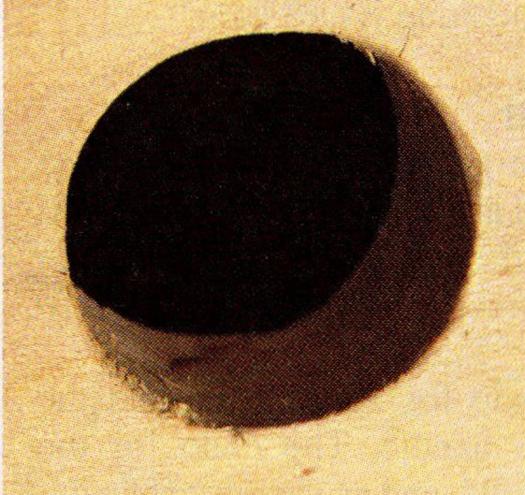

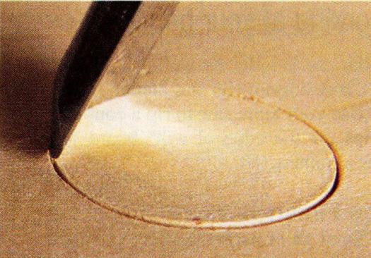

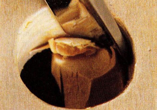

A well-made gouge will inscribe a perfect circle. Begin by inscribing a circle where you want the hole. Be sure to keep the beveled edge of the gouge vertical. Remove the wood inside the circle using the same gouge. Repeat the process as many times as necessary, always keeping the beveled edge of the gouge vertical. Care is necessary when the exit side of the hole is reached. Twist the gouge as you cut your way out of the wood in order to prevent splintering the exit side. If you are careful, your gouge-drilled hole can be as accurate as anything you would get with a drill.

Wood scraper
A carved surface has many facets
Scrape in direction of grain
Use strips of cloth-backed sandpaper
Apply pressure with your thumb
Pull in one direction
A deep crevice is sharp
Establish a strong stop cut
Curved tip knife
This is how the two knives meet

A good gouge inscribes a circle
Keep beveled edge vertical
Use same gouge for wood removal
Twist gouge for exit cuts
A perfectly gouged hole
