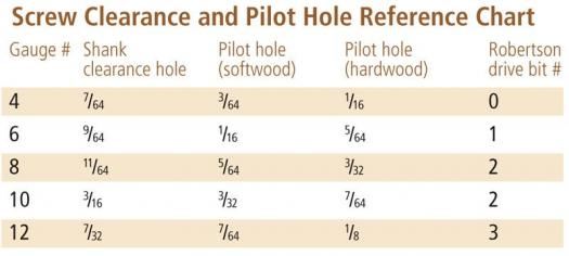

In general, pre-drill screw holes, specifically for hard woods, and always when installing screws near the end of boards – it will prevent splitting. Ensure that you select the appropriate bit for drilling (see ‘Screw Clearance and Pilot Hole Reference Chart’). If you are using tapered screws it’s best to drill two holes: an appropriate size clearance hole for the shank, and a smaller sized pilot hole for the root. You can buy tapered drill bits from Lee Valley that enable you to drill the right size hole to accommodate both the shank and root in one fell swoop. Often, the exit hole on the top piece of wood will have some blow out; a countersink makes quick work of ‘de-burring’ the hole. Due to the weakness of brass screws, install the same gauge of steel screw in a pre-drilled hole before inserting a brass screw.

screw clearance
