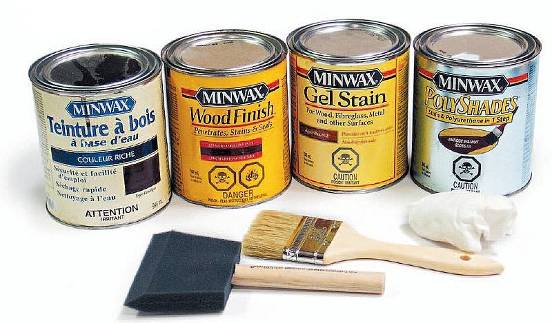

Minwax Stains
I’ve been using Minwax stains for several years with great success. They come in several formats (water based, oil based, gel, and blended with a polyurethane finish. One of the things I particularly like is that they are available in a wide range of colours, and I find that the same colours are consistent from can to can.
While the Minwax Water Based Wood Stain is easy to use, I find that it dries too fast for anything but the smallest projects. It also raises the grain on many woods because the water penetrates the wood and raises the tiny fibers. I dampen the wood and then lightly sand it before applying the stain. One of the main benefits of this stain is that it is compatible under any finish.
Minwax’s Wood Stain is an oil based pigment stain. This is the one I use most regularly on flat, horizontal surfaces. It dries more slowly than water based stain, giving me more time to apply it, particularly on large surfaces like table tops. I find that it adds more depth to the wood.
Neither of the two stains already mentioned work well on vertical work, or for work with a lot of detail. For this I use Minwax Gel Stain. This is a great product that doesn’t run, and seems to dry a bit slower than the Wood Stain. It’s especially good for use on carvings and turnings. And, it’s very easy to use – basically you rag it on, and rag it off.
Minwax PolyShades is a unique product, a pigment stain pre-mixed with polyurethane. The benefit of this product is that you do the staining and finishing together – an ideal proposition where time is of the essence. Of course you could still lay a couple of coats of polyurethane on top of this stain/finish for added durability.

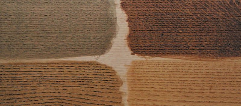

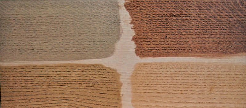

Top photo: one coat, bottom photo: two coats
Clockwise from top left: Minwax Water Based “American Walnut”; Minwax Wood Stain “English Chestnut”; Minwax Gel Stain “Aged Oak”; Minwax PolyShades “Antique Walnut”
