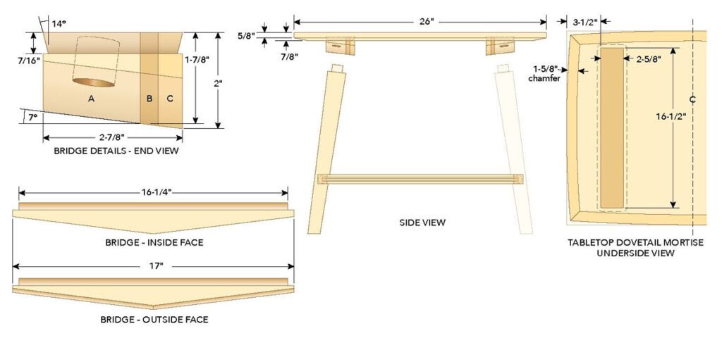

No matter if it’s a box, a tray, a table or a bench, almost anything that includes tapering compound angles offers visual interest and often greater stability. Dealing with those angles when it comes to joinery is fairly simple if you craft rotational flexibility into the joints.
Drawings and joinery
First, if a mistake is going to pop up, it’s better to make it on paper than with costly material. With any new build, I make accu­rate full-size drawings to act as a dimensional roadmap for the design and proportions, plus a surface on which to overlay parts while dry-fitting assemblies to confirm the build is going as planned (or not). But remember, dimensions are merely technical targets; the build is organic so I plan for subtly tweaking parts as the build evolves.
With all the parts jointed, planed to dimension and cut just over-length, I lay out and crisply mark where joinery will occur. The key to a no-fuss precise build is round mortise and tenon joinery. Turned tenons or inserted dowels with chamfered ends will self-align as you assemble because angles coming together along two planes in three dimensions will always meet a little off, so rota­tion allows fiddle-room to tune the fit without compromising the joinery.

The hidden element
Now on to the secret agent of the table, the two bridges. I found this the most time consuming, yet rewarding, part of the whole project. Each “bridge” is simply a length of stock, milled squarely to +3″ × 2″, dovetailed along its upper length, then ripped length­wise to yield a 2″ × 2″ and two strips 1/2″ and +3/8″ in thickness. The fun part follows: ripping compound angles along one face of the 2″ × 2″ to produce opposing facets for the table legs to join into squarely.
A pair of bridges, start to finish
Rout 14° dovetails along the two top edges of the milled blanks, 1-1/2 the thickness of the top they’ll be inserted into. On each blank, label the two dovetailed faces “in” and “out”, and the 3″ wide face between them “top” and its opposing face “down”.
Crisply mark the centre line of the length across all four faces of each blank. Next, rip a 1/2″ wide strip from the “in” face, creat­ing a floating dovetail strip (Part C) and set it aside. Now rip a 2″ wide part from the “out” side, creating a 2″ × 2″ “bridge” (Part A). Re-mark “in” and the centre line on its freshly ripped face. The remaining strip (Part B) will become the expansion strip later; set it aside for now.
Now’s the time to lay out the lateral and compound angles on Part A. With one blank on your bench, “in” facing up and “top” nearest you, lay out the chosen lateral angle (7° here) on the “in” face from the centre line at the edge where it meets the “down” face. Accurately mark that line to both ends of the blank. Next, lay out the compound angle (again, 7° here) down both ends of the blank as a continuation of the lateral line. After double checking the layout lines are equal on both sides of centre, rip both the lat­eral and compounding angles in one pass.
Time to taper
Switching to the tapering jig, from previously stock milled 1-1/2″ square and +15″ long, rip a pair of tapered wedges to exactly a 7° angle. Place one tapered wedge along the vertical face of the jig’s clamp ledge, and add your bridge blank, its “top” against the wedge, “down” facing outward and “out” resting on the jig’s base. By shifting the blank and the wedge fore and aft on the jig, the tip of the compound angle line drawn down the end of the bridge blank first aligns with the cutting edge of the jig, then is finessed to align with the tip of the sawblade, already tilted to 7°. With the blank and wedge snugged against the jig’s clamp ledge, clamp both pieces in place. Now, raise the blade and slowly rip a full cut through the blank as it rides the jig past the blade. One pass, two angles cut. Repeat this cut to machine the same angled surface on the other identical blank.
To rip the opposite compound angle on each bridge blank, reverse the wedge on the jig and align the opposing compound angle line with the jig’s cutting edge / blade tip as before and clamp in place.
With the blanks now ripped revealing opposing compound angled facets, now is a good time to complete the pair of bridge assemblies so they can be set aside until later. First, lightly plane and sand the facets, remov­ing any kerf marks. Next, mate the inside faces of Parts A and C, trace the facet profile of A onto C, then cut and shape C until their profiles match.
Leaving Part B with a square profile pro­vides a good clamping edge and shape to tailor the thickness when it comes time to fit the bridge assembly into the tabletop mortise; shape it after final assembly.
Locate the centre of the 1″ mortises for the legs and, aided by the compound angle plate set at the drill press, bore the mortises in the same facet of both “A” parts then reconfigure the plate set to drill the opposing mortises.
To complete the bridge assemblies, align all parts of each bridge then firmly apply paint­er’s tape along the top to bond each assembly together. At the table saw, with the blade raised the exact depth of the dovetail, remove 3/8″ from each end of each top to conceal the dovetail and allow for seasonal movement of the tabletop once assembled.

Bridge Parts
Here, the three bridge parts are overlaid on the full-sized drawing. The larger piece, what Salusbury calls “Part A,” has a double taper.
Bridge Parts
Bridge End View
The end view of the bridge assembly shows the outer parts (Parts A and B) along with the middle piece to hold the outer pieces away from each other. There’s a dovetail tenon machined on the bottom of all three pieces.
Bridge End View
Compound Angle Jig
A compound angle jig holds Part A from the bridge at the correct angle so the face of the taper on the underside of the part is level. This allows the mortises to be bored in Part A from the bridge at the correct angle.
Compound Angle Jig

Bridge Assembly
The bridge mortises are now complete. Salusbury first used a straight bit to remove much of the material, then used a dovetail bit to angle the outer edges of the mortise so it could accept the bridge assembly.
Bridge Assembly
Bridge Installed
To check for fit, Salusbury installed the three parts that make up the bridge in the mortise in the underside of the top. The thinner, centre piece is the last piece to be installed. It holds the other two pieces against the dovetailed sides of the mortise. Notice the two alignment dots, one centred on the edge of the bridge and one on the underside of the tabletop. When the two dots are aligned the bridge assembly is centred on the mortise.
Bridge Installed
