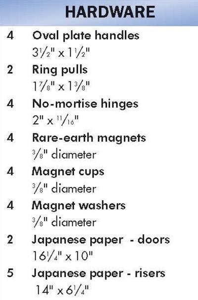

The paper I used is called Tokuatsu, hand-made in Japan and available in Toronto and Montreal at The Japanese Paper Place. Drastically different from thin Western paper, Japanese hand-made paper is world renowned for its amazing texture and versatility. Because wood fibers are woven together, the paper has strength similar to cloth.

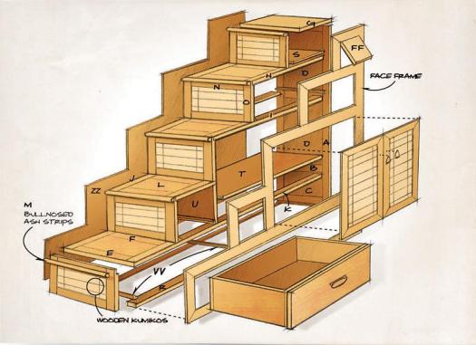

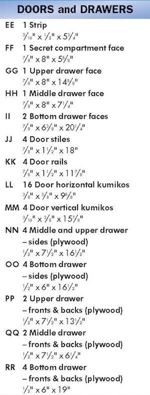

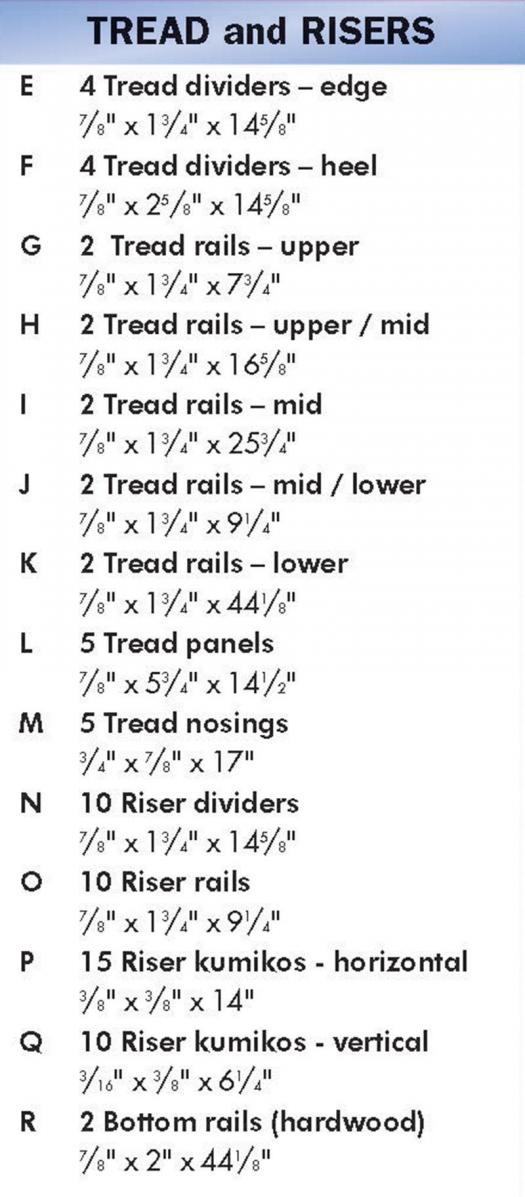

I machined the large end frame, five identical risers and five (almost) identical treads first. The length of the front and back rails for each of the five treads varies, decreasing as the treads ascend, requiring shorter front and back rails to connect to the end frame.

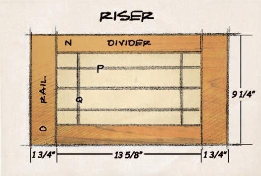

The end frame is typical frame and panel construction, but the risers are a bit different. The frames for the risers are machined the same way as the end frame, but in place of the panels are wooden kumikos. These horizontal and vertical wooden members join each other with a lap joint. A notch is machined into the frame to accept each kumiko. The horizontal kumikos are 3/8″ x 3/8″, while the vertical kumikos are 3/8″ wide but only 3/16″ deep. Since the vertical members are half the thickness, I cut lap joints in the horizontal members only – simplified construction and the addition of an interesting visual element.
With the risers assembled, I machined a 1/8″ x 1/8″ rabbet on the top, inside corner of each riser to offer a seat for the tread to sit in. Since the treads and risers are 7/8″ thick, this left a 3/4″ x 3/4″ gap. I routered a partial bullnose on the end of a 7/8″ x 3/4″ strip of ash to glue in the gap for added strength, producing a ⅛” overhang.
The front and back tread rails extend to the end frame and are secured there with a double dowel joint, the exception being the 2nd lowest tread. It is joined to the underside of the riser above it and is glued in place.
There are two rails extending from the bottom of the lowest riser to the bottom of the end frame. These add strength and allow a surface to attach the face frame and drawer slides. Both front and back rails are joined with dowel joints.

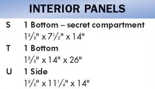

A solid bottom is required for the center cupboard and the secret compartment. These bottoms fit into the existing grooves machined in the sides of the front and back tread rails. A tenon must be machined on the edges of the bottoms to fit into the grooves.

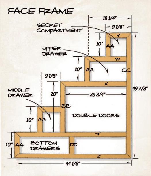

Once the glue has dried, I carefully laid it on its back and started machining the face frame. To streamline the process some planning was required. I decided where I wanted to use mitre and butt joints well before I began this stage – the outside corners are miter joints and the inside joints are butted. The butt joints were strengthened with dowels. The 1¾” wide face frame can be glued in place as you cut it. Before gluing the top piece of face frame into place, I machined a groove to accept a strip of wood. This 3/16″ thick strip secures the upper portion of the secret compartment. Once all the machining is complete to this stage, I dry fit every piece. To dry fit this piece by myself was difficult, but not as tricky as gluing, assembling and clamping the tansu alone! It is possible to do this by oneself, with some planning, but a second pair of hands makes assembly much easier.
The frame now machined and assembled, I take the dimensions for the two doors. I like to machine and assemble the doors so they just barely fit into the space then trim the doors according to the specific size and angle requirements. This takes a bit longer to do but the result is doors that fit perfectly. I also machined and installed an interior side frame on the left side of the centre cupboard to divide this area from the small drawer.
The mitred door construction is very similar to most doors, the two differences being the rabbet cut on the inside edge and the notches to receive the kumikos. The rabbets and kumikos are necessary for securing the paper. I had to keep the risers in mind while machining notches for the kumikos on the doors, wanting their proportions to be similar.

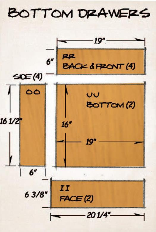

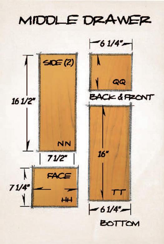

I attached the hardwood drawer slides and constructed drawer boxes to match. The slides are 1-1/4″ x 1-1/4″ solid with a 1/2″ rabbet to accept the drawer. I use wooden slides because they are long lasting and when well built, provide years of smooth and easy use. Solid ash slab drawer fronts are machined and attached to the drawer boxes.
At the bottom of the secret compartment, ash cleats are placed on either side of the opening directly behind the face frame. Rare-earth magnets with steel cups and washers – (from Lee Valley), are fastened to the wood cleats to secure the small panel. A 3/8″ hole accepts the dowel used to open the secret compartment panel. It is accessed from the open drawer below. A bit of pressure on the dowel overcomes the strength of the magnets, and the secret is unveiled.

Working with the hand made Japanese paper is not as difficult as might first seem. The Japanese Paper Place offers literally thousands of styles, colours and weights of beautiful paper and the rice glue required to adhere the paper to the frames. I cut the pieces of paper to the appropriate size, applied rice glue to the frame and kumikos then put the paper in place. Rice glue is water soluble, and easy to work with. Once the glue has completely dried I lightly sprayed the paper with water. At first this makes the paper swell and distort – without fail, causing my stomach to jump each time! After about 15 minutes the paper starts to contract, becoming taught on the frame.
Finally, I applied a furniture paste wax to the drawer slides to allow for easy movement, and fit the tansu with hardware.
