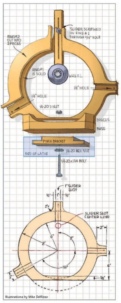

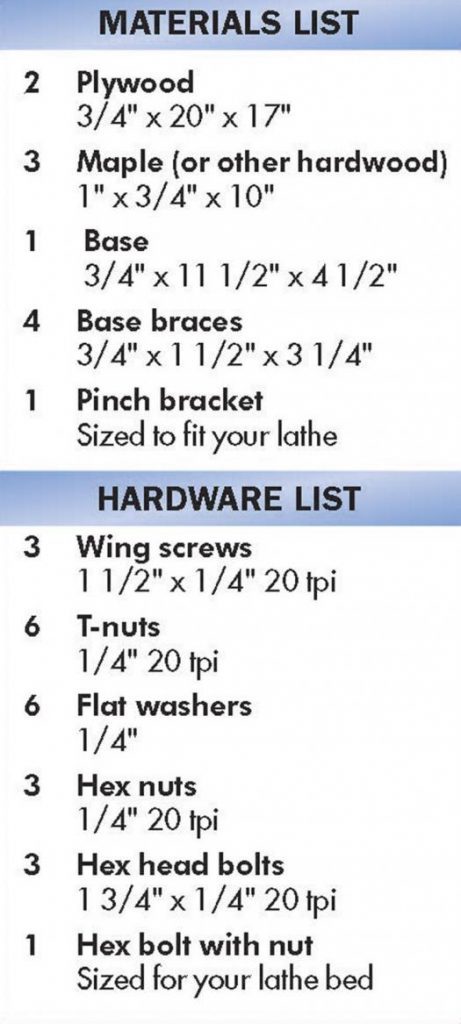

Begin by making the three sliders. Cut them to finished size from a piece of maple (or similar hardwood). Put them aside for later use. Next, make two identical rings (see illustration), using good quality plywood, Baltic birch or ‘medium density overlay’.
Mark the entire layout on one piece of ¾” x 20″ x 17″ material. Make sure you include the 1″ cut-out for the slider slot on your layout piece (for later reference). Fasten this to a second piece of plywood using two-sided tape.
Cut the outside profile of both rings at the same time. Drill an access hole near the inside layout line, and remove the center portion with a jigsaw.
On the layout piece only, cut out each of the three 1″ slider slots to the inside of the line. Assemble the three pieces with the sliders, and place on top of the second ring. Check the fit.
Use a belt sander, and sand the sides of the 1″ slots to the line, checking the fit often. All the pieces should align with the sliders and the edges of the rings. Once you’re satisfied with the fit, glue the three parts of ring 1 (the layout piece) to ring 2. Use the sliders to ensure proper spacing of the slider slot. Clamp the two rings together, remove the sliders and clean up any excess glue.
Once the glue has cured, sand all the edges smooth. Drill and counter bore the holes for the “T” nuts with a ¾” x ⅛” counter bore bit. Use a router to mill the slots in the sliders. Drill and counter bore for the “T” nuts. Before milling the slot in the base, check the thickness of your plywood and size the slot to ensure a snug fit.
Mill the parts for the base and braces from the scrap removed from the rings. To make the arch on the bottom brace, cut the parts square, hold them in place, and mark the arch using the rings as a guide. Cut the arch with a bandsaw or jigsaw. You will have to size the lower ‘pinch bracket’ to suit your lathe. The wheels I used are from a set of inline skates that I picked up at a yard sale. If you buy them second hand make sure you check the bearings for play. If you prefer, you can purchase new wheels from a sports supply store.
Assemble the base and braces (as shown). To use the jig, bolt it to the lathe, adjust the top wheel first, then the back wheel so they just touch the work piece. Then, adjust the front wheel to exert only slight pressure on the work piece.

This design is for a 12″ lathe. For a different sized lathe make the inner radius ½ the lathe capacity (i.e. 5″ for a 10″ lathe). Add 2″ to that for the outside radius. Adjust the width of the base and the length of the sliders to suit.
