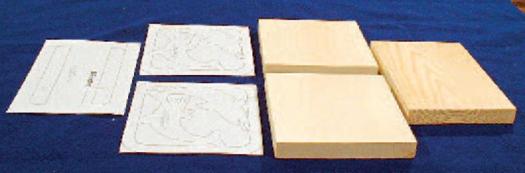

Prepare the Project Pieces
•   Cut your project pieces to size.

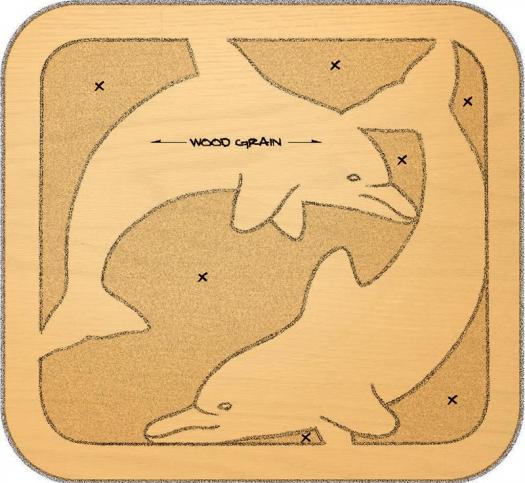

•   Trim the patterns to fit the wood. Do not cut the round corners off of the pattern, leave them square.

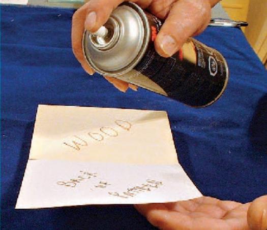

•   Apply two small pieces of masking tape to the top side of each pattern. Then fold it over onto the upright pieces. This will make a tape hinge for the next step.
•   Fold the pattern back (like opening a book) and spray glue on the back of the pattern. Make sure you do this over some newspaper as the over spray will make your work area very sticky. Let the spray glue dry until it is very tacky.
•   Carefully fold the pattern back over the upright pieces and press it down. The tape hinge will keep everything lined up, but keep an eye out for any shifting of the pattern as you press it down.

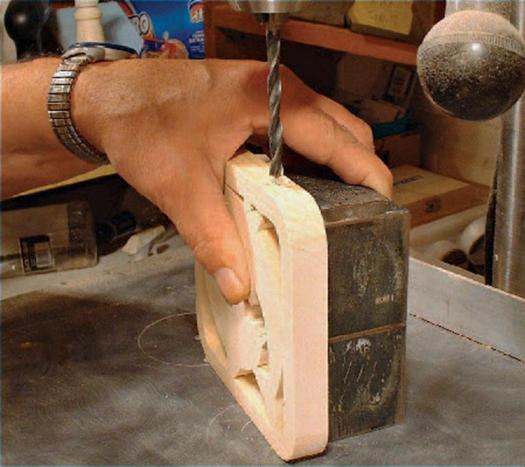

•   Mark the location for the dowels on the bottom of the upright pieces.
•   Use a drill press to drill ¼” dowel holes ⅜” deep on these marks. Do not drill all the way through. (Tip: use a block of steel or wood to help hold the project pieces straight, so the dowel holes will be square.)

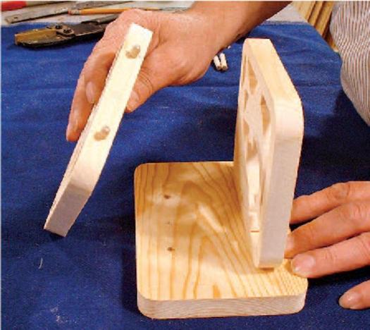

Assemble the Napkin Holder
•   Dry fit the pieces to ensure that the dowels are not too long.

Areas to be cut out are marked with an x.
Project parts

Fold pattern back and spray glue
Drill dowel holes
