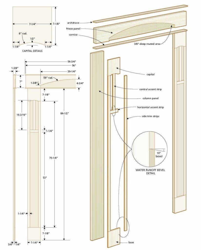

The plan is to create a pair of side columns to visually support an entablature top, in this case because the door has a lot of blank sid­ing above it. If the door had been tightly confined above by a soffit, narrower built-up trim, similarly styled, would complete the scene. The columns and entablature assemblies are simply crafted from a panel of wood with details applied to celebrate the elements of the door and lamps.

The door jamb here is capped with a 1-1/4″-deep aluminum molding that I didn’t want to disturb, so I made my columns 1″ thick from 3/4″-thick panels with 1/4″-thick detail pieces applied, creating a nice +1/8″ setback shadow line between molding and my trim, once installed.
To decide on the length and placement of the elements on my trim, I referenced the doors window and grillwork. A hori­zontal element defines a change in the wrought metal grill, so I transferred that elevation as where I’d anchor my design; above that line I applied my feature details and capital, and below that, a simple border. At the bottom, a base panel is applied for the design to visually rest on. I chose 7″ for the column width, roughly a golden ratio of the door’s 36″ width. As for height, I designed the panel to come flush with the door’s top molding for the entablature to rest on, and I left space below the column for airflow, deterring decay.
The entablature assembly begs to have attractive visual mass; it should honestly appear to be supporting the structure above it, even though it’s just trim. Too wimpy and it just won’t feel right, plus it won’t create a shadow line where it rests on the columns, defining that junction. The frieze component I decided on is 1-3/8″ thick to which I applied a 1-3/4″-wide bull-nose molding top (cornice) and bottom (architrave) to add visual mass and definition.
To soften the linear / rectangular features, a curved arch is shaped within the frieze panel and at the bottom of each column’s capital. The house has an arch feature below the peak of the porch roof above the door, and the grillwork in the door reflects that detail; I carry that feature on in my design.

The capital and base panels are cut to 7″ in length, so once installed, the bottom of the capital meets the top of the vertical elements laterally, in line with the top of the door’s window for hor­izontal continuity. To create the capital’s arch profile, I marked the part’s centerline, plus points 1-1/4″ in from each edge of the piece of stock and drew a 6″ radius from point to point. I experimented earlier to find a pleasing radius by tracing around paint cans, sand­ing discs, trash cans … anything circular; a 12″ lathe faceplate was just right. Next the arch profile was carefully cut at the band saw and sanded to final shape at my belt sander, making sure to stay within the 1-1/4″ margins.
With layout lines drawn on the back panels for accurate place­ment of the detail elements, now’s the time to cut all the detail parts to length and chamfer the ends where the parts will meet. I carefully crosscut a 10° bevel across the bottom of the capital, and the top edge of the short detail cross-member and base panel, plus a mating bevel at the ends of all vertical intersecting strips. Thus, where the parts butt together will be tightly overlapped and once finished, any weather-related moisture may run off and away for durability and cleanliness. Also, the top of the short vertical detail strip, central to the design, needs to be radiused to match the arch radius and its bottom edge beveled at 10°.
The entablature
The entablature references all its features by centering itself above all the vertical elements of the door, moldings and soon-to-be col­umns below it. By summing the width of the door and moldings, the two columns plus adding a decorative 1″ extension at both sides, I arrived at a finished stock length of 56″ for my 36″-wide entrance door. From a 60″ length of 10″ wide 8/4 stock, I jointed and dressed down the 7″-wide frieze panel to 1-3/8″ thickness plus two 1-3/4″-wide strips left a fat 3/8″ thickness to trim the frieze top and bottom.
I wanted the frieze arch to become a strong visual extension of the door’s side molding, creating a soft frame above the door. Referencing the outer edges of the door moldings, I drew vertical lines 39-1/4″ apart and marked points 1-3/8″ in from the bottom edge. Using these points, plus the panel’s center line, I arrived at a pleasing arch profile that worked well with the width of the frieze as well as the shape of the arch in the wrought metal grill of the door below. Satisfied, I accurately recreated and smoothed the shape on some utility 3/4″ plywood to create a routing jig I could reposition incrementally over my stock to rout, then sand the arch profile 3/8″ deep across the face of the frieze. Next, the still-fat cornice and architrave parts were dressed down and sanded to an accurate 3/8″, cut to final length of 56-3/4″ and given a 3/8″-radius bull-nose profile along the soon-to-be leading edge and ends.

In order to ensure water will run off any horizontal surfaces, rather than sit and cause problems, Salusbury machined a 10° angle into the horizontal surfaces of the trim. He also cut the mating trim at 10° to ensure a tight fit.

Salusbury cut an arc into plywood, making a routing template so he could smoothly rout the arc into the trim that makes up the face of the frieze.
