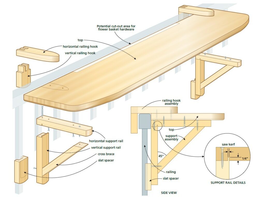

Start with the bar surface
There are three main components to this build: the surface, the supports and the railing hooks. I’ll start with the surface, as the other two parts are built with its dimensions in mind.
After a few months of use, I find 11″ deep is comfortable for a regular-sized dinner plate. However, if there was room I would add another 2″ to this. In terms of length, this is going to vary for every­one. I made the surface 56″ long, which I find is enough for two people, with a bit of added room for drinks, napkins and cutlery. If you’re going to make the bar surface long enough for more than three people I would suggest adding extra brackets to support the surface.
And if you feel the crowd could be rowdy and exert a more-than-normal force on the surface while dining or drinking, an extra bracket will also reduce the chance of a catastrophe. The two brack­ets I used are quite strong and I have no worries about something giving way.
With the railing bar surface dimensions determined, machine the surface. I laminated two planks of white oak to give me enough width to work with. Next, I added a curve to both front corners. I sketched a shape onto the surface then faired the curve with a French curve template. A bandsaw or jigsaw will remove most of the waste and a belt or edge sander will smooth the cut edge. I added a round over to the underside of the surface at this stage. There will be a bit more work to do on the surface, but I saved that for after I had a chance to work out a few other details.
The support assemblies
I made two support assemblies to keep the bar surface square to the railing and assist in supporting it. The exact dimensions of these parts aren’t critical as long as they will fit underneath the top without becoming an eyesore. Because these parts are on the small side, and there are multiple parts that are exactly the same, I machined a blank that was just over twice the width of the fin­ished parts, machined the joinery, then ripped them to final width. I cut the parts to finished length, then ran a small blade kerf toward the ends of the horizontal support rails. This kerf would eventually accept a tenon from the vertical support rails and only needed to be about 1/4″ deep and the width of a blade. The location of the kerf needs to be positioned so when the hori­zontal support rails mate with the vertical support rails, the vertical support rails are flush with the ends of the horizontal sup­port rails.
Next, machine a tenon on the ends of the vertical support rails to fit into the kerf. At this point you can rip the workpieces in half. Dry assemble the support brackets and obtain the length of the cross braces. Cut these so the horizontal and vertical support rails finish an inch or so beyond the cross braces.
Mark small arcs on the ends of the hori­zontal and vertical support rails, then cut and sand their ends. This is to ease the sharp corners in case anyone bangs their knee on them in use.
Drill a pilot hole through the horizon­tal and vertical support rails into the cross braces, then counter sink the holes in the horizontal and vertical support rails. At this stage it’s a good idea to mark all the parts so you’ll know how they fit back together.
Once the parts are sanded, and you’ve broken any sharp edges, glue and screw the supports together.
Finally, build the slat spacer to make up the difference between the inner face of the slats and the inner face of your railing. This will allow the supports to sit close to flush with the rear edge of the surface, but still come into contact with the slats. This was 5/8″ in my case. These pieces are essentially rectangular pieces with a dado in them slightly wider than the width of the slats.
The railing hooks
The railing hooks are high on the list of importance to the suc­cess of this project. They need to be strong enough to support the surface and whatever force users add to it.
Small pieces are harder to machine, so I left the blanks long enough to obtain two parts from. I broke out two blanks that each contained a horizontal and a vertical railing hook combination.
It’s important to note that while the two blanks each have one horizontal railing hook and one vertical railing hook, the joint cut on one blank will actually mate with a joint cut onto the other blank. This is just so you can test fit each joint while it’s in a lon­ger, more easily machined, blank. It’s obviously impossible to test a joint’s fit with the mating part if that mating part is connected to the other end of that blank.
Although other joints could be used to connect these two pieces, a finger joint provides lots of glue surface area and will create a strong joint. I started by cutting the outer finger notches in the ver­tical railing hooks. With a jig that held the parts at 90° to the blade and a dado blade in my table saw, I adjusted the jig to cut a notch in one side of the workpiece, then rotated the part to notch the other side. I repeated this for the other vertical railing hook.
After adjusting the jig to cut another notch as close to centre as possible, I machined the centre notch. Then, to ensure the notch was perfectly centred on the workpiece, I rotated the workpiece 180° and recut it.
Next, the mating finger joints were cut in the horizontal rail­ing hooks. I started by marking the locations for the finger notches on the workpiece. Use a dado blade that’s a bit narrower than the finger notch you need to cut. Adjust the jig to machine the outer face of the joint first. You can check this setup by making a pass and then laying both parts of the joint edge-down on a flat surface and bringing them together. When they align you can cut the other workpiece, then rotate both workpieces and machine the other fin­ger notch on the opposite side of the joint. If you’re going to err on either side, I would leave a bit of extra material on the joint, as you can always shave it down with a shoulder plane or chisel. Gluing on a piece of material to make up for a gap is possible, but it takes more time.
Adjust the jig to cut the inner sides of the finger notches and run the parts over the blade. The final fit should be snug, but not super tight. Sand the inner faces of the parts and glue up the railing hooks. When dry, mark the curves on their ends then cut and sand them smooth.
You can now screw the railing hooks to the surface. The gap between the rear edge of the surface and the inner face of the hooks should be 1/8″ more than the width of your railing. Just screw them in place for now.

Illustration by Len Churchill
[illustrations_gallery]
Railing bar illo
Railing bar material list
