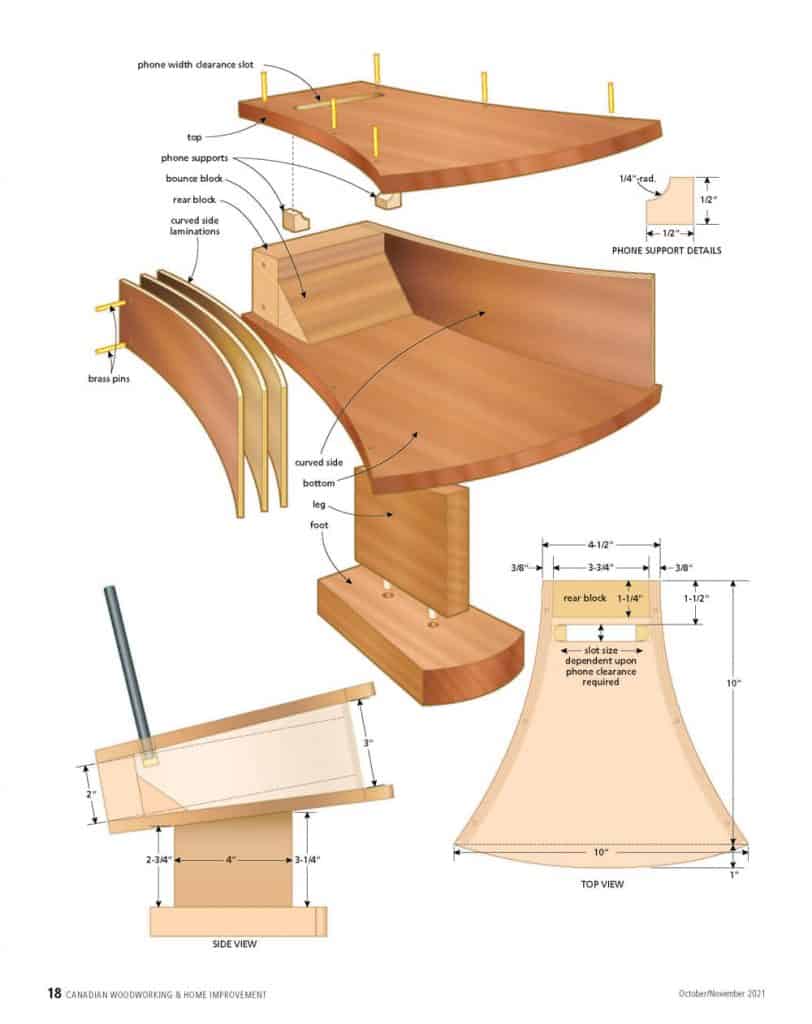

Before making the form, I made a drawing on a piece of graph paper to give me a close approximation of both the shape and size of the speaker. Once I was happy with the sketch, I cut up five pieces of MDF. With a few modifications this form can be used in a vacuum bag to bend wood.
Start off by driving a pair of screws along the curve’s path part­way into one of the MDF pieces. I used a cut-off piece of 1/8″ thick MDF to create my curve between the two screws. Most any clear piece of wood around the same thickness will do the trick, as well as store-bought options like a French curve. Play with the shape until you’re happy and then pencil it in. Next, cut this on a bandsaw and refine it with sanding. Take your time with this step to make a smooth curve because this will become the pattern.
It’s simple to create identical pieces by using a combination of a bandsaw and router fitted with a flush trim bit. First, create a 90° corner jig using a pair of MDF pieces, glue and screws. Seat one of the blank MDF pieces in the jig, then place the curved template on top. Using a countersink and three #8 × 1″ screws, attach the two pieces together. Keep the screws close to the outer edges, as you’ll need to drill holes for clamps in the middle. Head over to the band­saw and cut the curve, leaving approximately 1/8″ of waste. Take your time and don’t cut into the template.
At the router table, place a flush trim bit with a bearing on its tip in the router and adjust the height so the bearing rides on the tem­plate. Route the assembly to give yourself two perfectly matched pieces. Head back to your bench and place a blank into the 90° jig. Next, put three or four drops of medium Instant Bond CA adhe­sive on the assembly and spray accelerant on the blank. Lay the assembly on top of the blank and let it set for a few seconds. Turn the new assembly over and drive in three screws, once more keep­ing them close to the edges.
A few more touches
Keep repeating the steps with each blank and in short order you’ll have a form that is 3-3/4″ wide. Sand any sharp edges and apply packing tape to the form so your lamination doesn’t stick to it. I drilled four 1-1/2″ holes completely through the form to accommodate the pads on my F-clamps. Adjust the position and hole size to work with the clamps you have in your shop. To find the positions of the holes, place the clamps perpendicular to the curve. Remember to avoid the screws holding the form together. One other addition is to place two small blocks on one side of the form to help align the laminations during the gluing process. These blocks are roughly 3/4″ thick by 1″ wide by 4″ long. Cover these with packing tape before screwing them to the form between the clamps. Make sure they are at least 1″ above the curved surface as four pieces of 1/8″ hardboard will be used as clamping cauls.

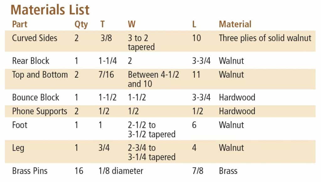

I wanted to make the curved sides of the speaker 3/8″ thick to make it light yet easy to join to the top and bottom. This will require three 1/8″ thick pieces for each side. When laminating wood, the thinner the individual slices, the easier they are to bend. While our bend is not too radical, it is made easier with thinner slices. Thinner slices mean less spring-back when the lam­ination comes off the form.
Start off by milling a piece of wal­nut or wood of your choice 1-1/2″ thick by 3-1/2″ wide and 15″ long. Longer and wider allows some wiggle room to clean up the laminations after the bend is formed. It also lets you select the part of the curve that suits you best. Set the bandsaw up to re-saw 3/16″ thick lami­nations. Depending on how well your bandsaw is tuned up, you might need to take the last lamination from another section of the plank. Whenever I make laminations, I mark up one edge with a woodworker’s triangle to keep the lami­nations in the same order in which they came off the plank. By gluing up the laminations in this same order and using white glue, which dries translucent, it makes the lamination look as if it grew in this particular shape. Even though the edges of this project will be covered, it’s a good practice to follow.

To make sure the phone doesn’t drop through and come to rest on the bottom, make supports that are small enough to hold the corners of the phone yet not block the speaker. Once more, this is dependent on the make and model of your phone. Supports can easily be made by taking a small, square piece of wood 1/2″ thick and 1-1/2″ square. Drill a 1″ hole through the center and cut it into four pieces. You’ll need two pieces which will even­tually be glued to the underside of the top. With the top dry-fit into place, adjust the supports as nec­essary. If you know you’re rougher with things, make these supports a bit larger. You don’t want them to break down later.
I’m not a sound engineer, but I imag­ine that sound waves bounce similarly to billiard balls. With the phone sit­ting perpendicular in the top’s slot, the speaker will bounce the sound waves straight into the bottom. In practical use, this worked well, but while experi­menting I found that placing a piece of walnut cut at 45° against the rear block improved the output. With the curves and tapers of the speaker, fit this bounce block as close as you can. It doesn’t need to be a perfect fit for it to work.
