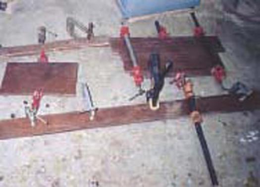

Prepare your stock by edge-gluing to required widths. My stock was ½” thick so the photo shows some parts being glued to double thickness.

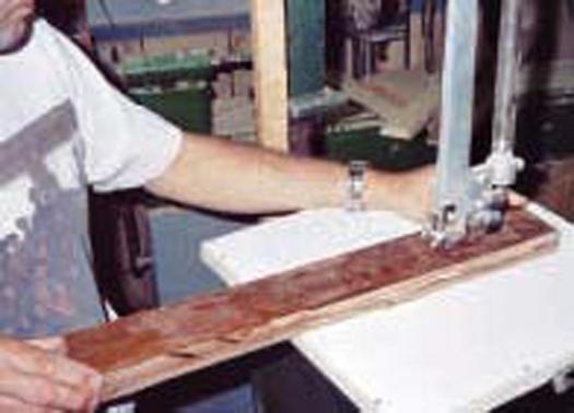

Trace the templates onto the stock and cut the shapes using a band saw or jig saw. A band saw greatly simplifies this project. Cut the tenons to the shapes on the templates. The tenons should be ½” wide. Turn each crossbar 90 degrees and cut the tenons to ½” thickness. The tenons should look like ½” cubes when done.

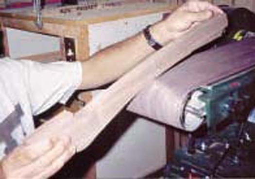

Sand the parts. The tight curves on the legs and the crossbars are best sanded using drum sanders in a drill press but they can also be hand sanded. Sand the tops smooth and even up the curved edges with a belt sander. The concave sides of the legs must be done using the end roller of a belt sander.

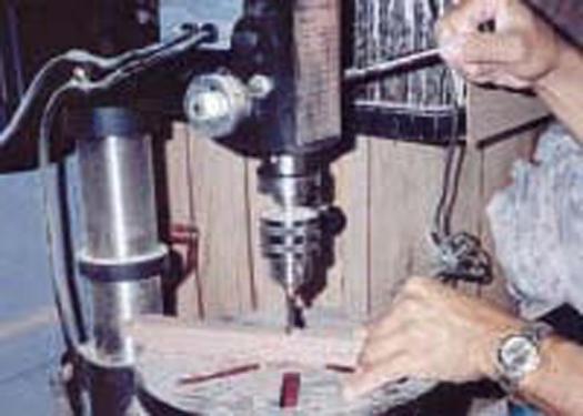

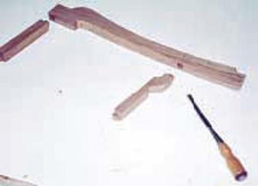

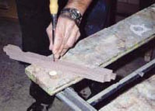

On the full length stringer (#2) and the full length cleat (#4), mark the center point of the side. Using a ½” Forstner bit, drill a hole ½” deep in the center of each part. Using a sharp chisel, square the corners of the holes. Test fit the tenons of the half stringer (#3) and the half cleat (#5) into these mortises, adjusting with the chisel as required. Don’t worry if the fit is a little sloppy.
On each leg, cut two more mortises in the same manner. The locations of the mortises are marked on the grid diagram. When drilling the lower mortise, make sure to prop up the part as required to drill the mortise parallel to the top & bottom of the leg. Square up the mortises with a chisel and test fit the parts.

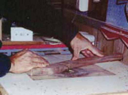

Using a ½” or ⅜” radius router bit, round over the outer edges of the legs. A router table greatly simplifies this process. Leave the ends and the inner edges square.

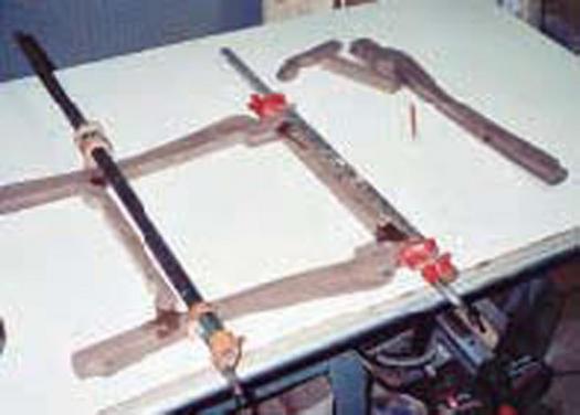

On the full length stringer and cleat (#2 & #4), apply glue to the tenons and insert them into their mortises. Gently pull the joints together with pipe or bar clamps. If excess glue was used, allow the glue to be gently squeezed out of the joint. If excessive force is used, the parts may split from hydraulic pressure. Make sure the assembly is flat. Check that the assembly is square by comparing diagonal measurements, adjusting as necessary. Wipe up squeezed out glue thoroughly with a wet rag.
STEP 7

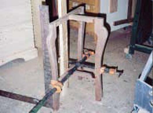

When the glue has set for at least 30 minutes, clamp the remaining leg, the half-stringer (#3) and the half-cleat (#5) together, as shown. A piece of scrap lumber can be used vertically as shown to allow the use of a single clamp. Stand the assembly on a flat surface and check that it is square using a carpenter’s square.
