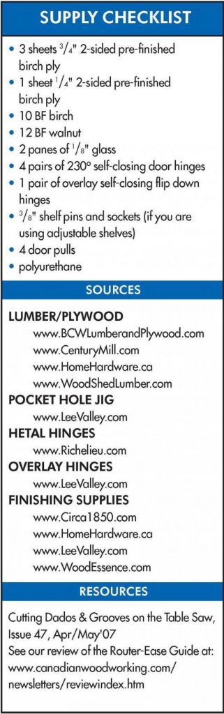

I used two-sided pre-finished birch plywood for the tops, bottoms, sides and backs, and spalted maple and black walnut for contrast and accents. I was fortunate to find the spalted maple in a second hand shop on Saltspring Island that was already re-sawn and planed to 316″.

I chose 230º Hetal hinges for the four front doors on the unit. They were easy to install (with the right size Forstner bit) and are self-closing and slightly adjustable to get all the gaps around the doors as perfect as possible. For the flip-down door I used a pair of simple European Blum overlay hinges that are also self-closing and adjustable to get perfect alignment with the top and bottom doors.
