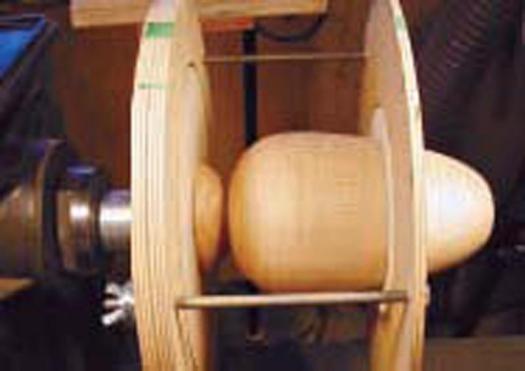

The doughnut chuck, in its simplest form, consists of a plywood circle attached to a faceplate, a separate plywood ring, and three or more bolts with wing nuts. (Alternatively, the faceplate circle could be made to fit into the jaws of a chuck.) A bowl or hollow vessel is then sandwiched between the two pieces of plywood and the bolts hold the whole thing together.
To make a doughnut chuck, you will need plywood, a dedicated faceplate, screws for the faceplate, some foam padding, several bolts of the same diameter in various lengths and matching wing nuts.

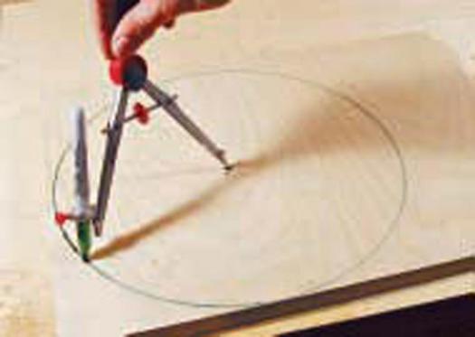

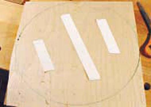

Begin by selecting some plywood of the appropriate thickness. As my vessels are generally small and lightweight, I use ¾” plywood for the faceplate circle, and ¼” plywood for the ring. For heavier pieces, you may want to use thicker plywood. Attach two (or more) pieces of plywood face to face with double stick tape.

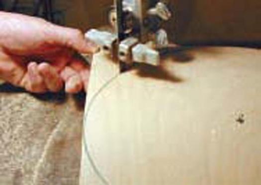

Cut this stack of plywood into circles with a bandsaw. The diameter of these circles should be at least two inches larger than the diameter of the largest bowl (or vessel) for which the chuck will be used.

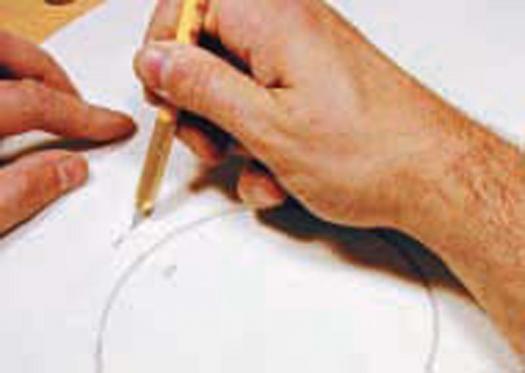

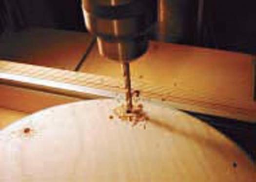

While the plywood circles are still connected by the tape, drill three (or more) equally spaced holes centred approximately ½” in from the outer diameter of the circles. The diameter of these holes depends on the bolts you will be using (I use ¼” bolts of lengths ranging from 3” to 6”). Bolt the circles together.

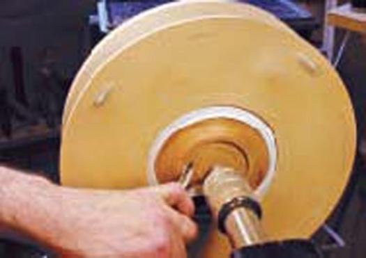

Attach the faceplate circle to a faceplate with screws of appropriate length.

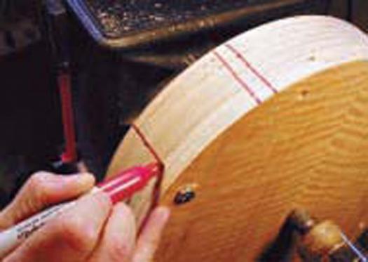

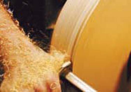

Mount the entire assembly on the lathe. True up the outer edges of the circles on the lathe. Mark the edges of the circles so that you can align them the same way each time.

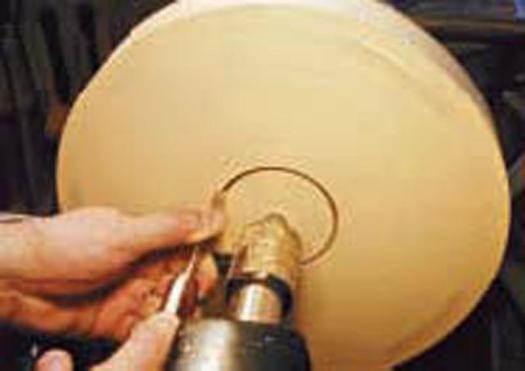

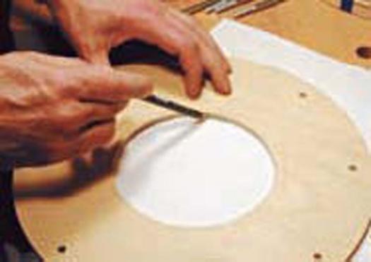

With a parting tool, remove a circle of an appropriate size to create the plywood ring. Note that the diameter of the opening in this ring should be large enough to allow the foot of the bowl to be fully exposed for the reverse turning, but not too large. I make several different rings with openings of various diameters so that the chuck system can accommodate a wide range of turnings. Dismantle the assembly.
Cut some protective foam padding and glue it to the surfaces of the faceplate circle and the ring where they will touch the turning.
You are now ready to use the chuck.

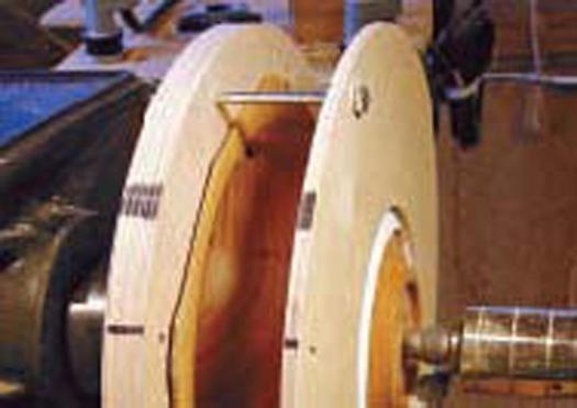

Mount the bowl in the chuck with the rim on the faceplate circle and the bottom protruding through the ring. Secure with bolts, being careful to put the wing nuts on the headstock side.
Mount the assembly on the lathe. The tailstock can be used to align the centre of the bowl and hold it in position as you tighten the wing nuts. Don’t over tighten, as it is possible to crack a thin bowl.
When the chuck is fully tightened, you can turn the bottom. I usually leave the tailstock in place as long as possible for safety, but it can be removed for completing the bottom. I always use this chuck at a fairly low speed – perhaps 600 or 800 rpm at maximum.

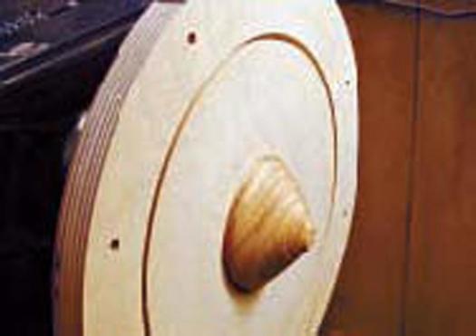

The hollow vessels that I turn have small entrance holes – from 1” to 2” in diameter. To aid in aligning a vessel, I add a wooden cone in the centre of the faceplate.
