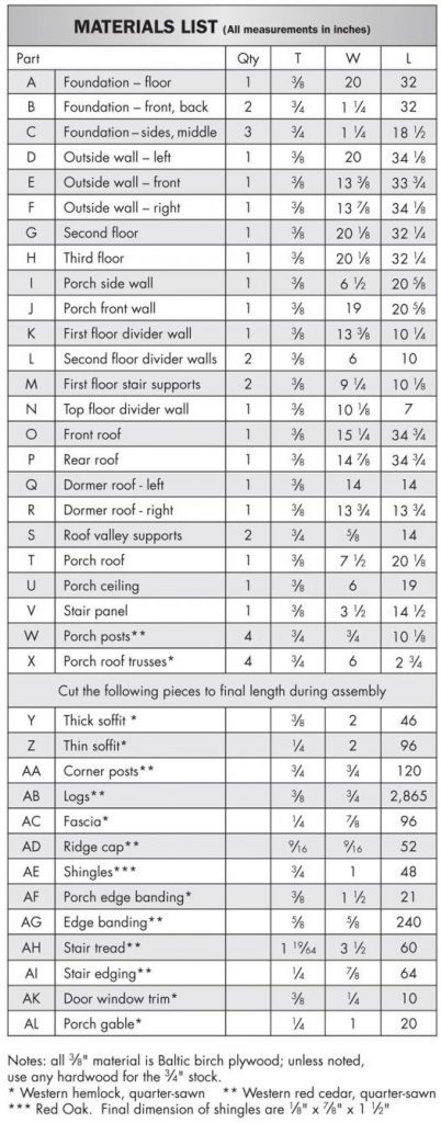

In order to make it easier to follow the MATERIALS LIST, the parts are all identified as seen when facing the front facade of the dollhouse.

dollhouse materials list
doll house cut list
