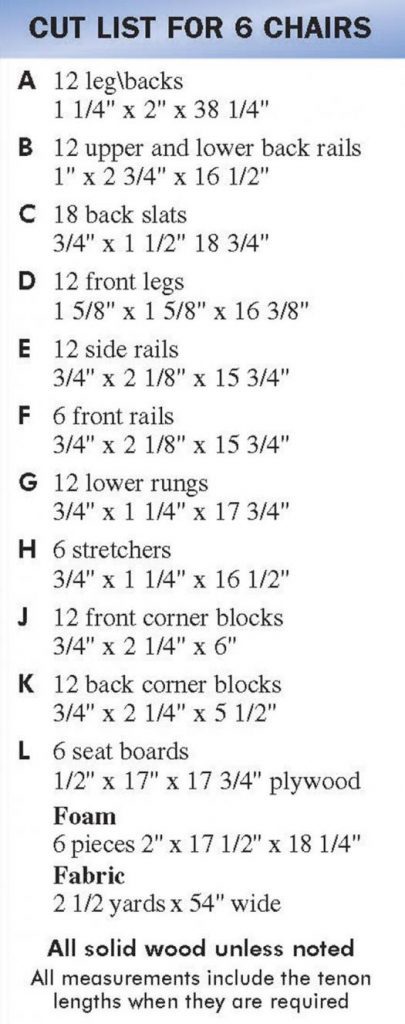

The chair is assembled using mortise and tenon joinery. There are, however, a couple construction steps that require a lot of attention and some skill (i.e. cutting the back leg assemblies and forming the mortises). Just don’t rush through the project; it’s really not all that complicated if you take it one step at a time. I didn’t show a materials list for this project because you can use a lot of cut-offs in your shop for chair construction.

Cut all the leg/backs (A) on a band saw. Follow the outside profile of the line, leaving the pencil marks visible to help guide in the sanding stage. Sand all the parts using a drum sander and a random orbital palm sander. The twelve leg/backs can be cut from four boards that are 1-1/4″ x 5-1/4″ x 96″.

At this point cut the twelve back rails to size, and machine the tenons on each end. The rails (B) are 16-1/2″ long, which includes a 3/4″ tenon on both ends. The tenons should be 1/2″ x 2-3/4″, centered on each rail end. They can be cut with a stacked dado blade that’s set 1/4″ above the table surface.

There are three back slats (C) which fit into the top and bottom back rails (B) for each chair. The slats require a 1/2″ x 3/4″ tenon that’s 1-1/4″ wide on each end. The three slats are equally divided across the rails with a 2-5/8″ space between them. The rails (B) need three mortises, centered on each rail, to receive the slat tenons.
Be sure to verify your measurements before cutting the slats to length. The distance between my (B) rails is 17-1/4″, which means my slats must be 18-3/4″, because of the 3/4″ tenon on each end.

The side rails (E) are 3/4″ thick material with an overall length, including tenons, of 15-3/4″. Note this blind mortise and tenon joint requires an offset tenon on the front end of the side rail. The cheek cuts are 1/8″ deep to center the tenon, but the end cuts are different. You may also have to cut a small corner off the tenon that fits into the leg/back assembly to clear the back rail tenon.

The front rails (F) are cut to a total length of 15-3/4″, which includes the 3/4″ tenon on each end. Both ends require an offset tenon. The cheek cuts are 1/8″ deep to form a 1/2″ tenon. The end cuts are 1/8″ and 1″ deep to create the offset to fit the front legs. Dry fit all the parts. Your mortise and tenon joinery should fit snug but not too tight or too loose. Too tight and all the glue will be removed as the tenon is inserted. Too loose and the gap will not allow the adhesive to bind the parts. After assembly, verify the rung and stretcher dimensions, in case your leg/back is formed differently than mine.

The seat platforms (L) are made using 1/2″ plywood. The back end requires two notches to fit between the leg/back boards. Once they’ve been cut to size, round over all the corners so they won’t damage your fabric.
Cut Foam
Cut a piece of 2″ foam that is 1/2″ greater than the length and width of the seat board. The foam will extend past all seat board edges by 1/4″. The foam can be cut with a utility knife and glued to the seat board with spray adhesive.

Cut your fabric 25″ square. Center the seat on the material and attach the front and back with a staple in the center. Next secure both sides of the material with a staple at the center point. Pull the material so it’s snug but not stretched.
