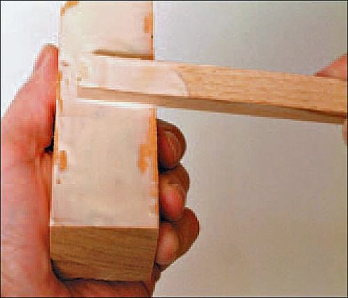

Apply a generous amount of waterproof wood glue (such as Titebond III) to the mating edges, smoothing the glue to ensure it covers the entire surface. Clamp the strips together, making sure they lay flat and that the top surface is flush along the entire glued-up board. This is important to reduce the amount of surface planning you have to do in order to create a smooth surface.
After half an hour, scrape off any dried up glue, but don’t remove the clamps. Let the glued up board cure overnight.
