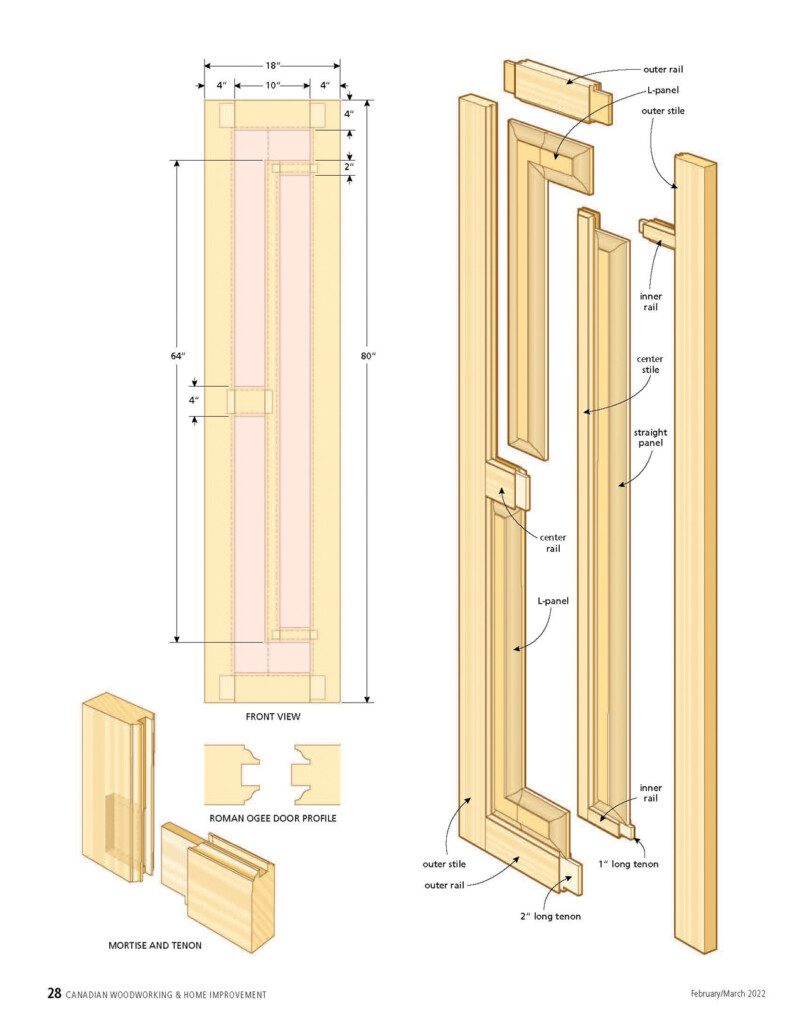

I used the Freud door kit #99-268, though there are other options on the market. Freud has many door profile kits, but this particular one (Roman Ogee) is my favourite. Please follow all guidelines indicated from the manufacturer for this set and follow safety precautions for your router setup. Freud has extensive instructions that come with the set, but I will also explain some of the setup details here.

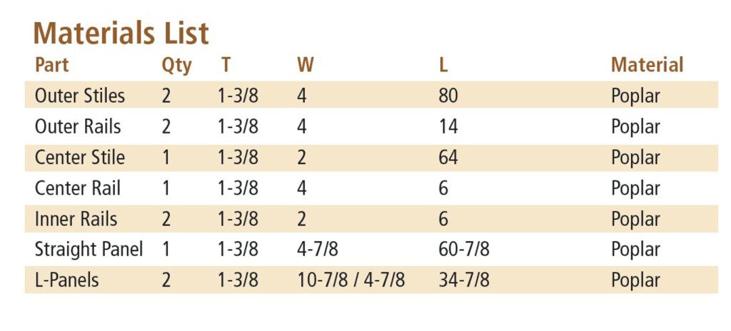

The measurements discussed here are for an 80″ high × 18″ wide door. Other cutters may have different dimensions, so the lengths of your rails may need to be different than mine to obtain the same dimension of door. I recommend drawing your door dimensions out full-size before starting to build it.
To determine the length of the rails, start by determining the length of the tenon for the outer rails. For strength, I want tenons half the width of the stiles, therefore 2″ long. Given the door’s final width is 18″ and each stile is 4″ wide, the formula is 18″ minus 4″ minus 4″ equals 10″. Next, add 4″ (2″ tenon length × 2 sides) to account for the two tenons on the ends of each rail.
The calculation to determine the lengths of the other rails (the rails other than the outer top and bottom rails) is as follows. The visible length of the short center rail is 4″ and there are 1″ long tenons on each side of this rail. Therefore, 4″ plus 1″ plus 1″ equals 6″. You’re probably wondering why I went with 1″ tenons here, instead of 2″ tenons. These parts are less structural than the outer two rails and stiles, so less strength is needed. The lengths of the two inner rails are calculated in the same way.
With all the rails cut to length, you can mark a tenon location line on the edges of the rails, near their ends. Add a mark 2″ in from the ends of the two outer rails and 1″ in from the ends of all the other rails. These lines will give you something to shoot for while machining the 1″ and 2″ long tenons.

Two Different Tenon Lengths
Zakarian marks the edges of the rails either 1" or 2" from their ends. These lines help him machine the tenons to the correct length. He stops moving his router table fence away from the blade when the router bit stops exactly at the pencil line. This tenon will be for one of the outer joints, as it will be 2" long.

A hollow chisel mortiser is a good way to machine deep mortises in these workpieces, though a router or hand tools could also be used. The finished mortises are flush with the sides of the grooves.
Notched Tenons
In order for the tenons to fit around the 1/2" wide shoulder beside the mortises, you can use a bandsaw or hand saw to remove 1/2" of material on the edge of the 2" deep tenons.
