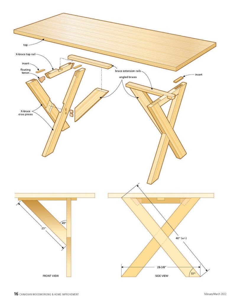

Build an X-base dining table
X marks the spot (to start)
I drew a full-size layout on a large piece of paper so I could be sure of the angles and dimensions. The base sections each had to be wide enough to give the width of the table stability.
I began by milling the material for the leg sections to final thick­ness, then ripping the parts to final width. I left the main cross pieces long at this point, as I was just going to trim them to length after they were assembled.
Taking the angles from my drawing, I adjusted my miter gauge and installed a dado set in my table saw. After a few adjustments to dial in the half lap joint connecting the two cross pieces, I removed the waste from each joint. I was able to remove this material from all the cross pieces with the same miter gauge setup. I marked lines on the workpieces, and cut directly to those lines, checking frequently against the mating piece as I got close. To ensure gaps weren’t created after the fact, I sanded the sides of the cross pieces before ensuring a perfect fit.
With the half lap joints dry assembled there was no movement between the pieces. I clamped them to a work surface with their upper ends overhanging the surface, then used a track saw to trim them to final length. I still left the bottom ends of the legs long at this point. I was now ready to fit the horizontal braces and cut the joinery to secure them in place.
Top rails and open-ended mortises
The first thing to do is to cut these two rails to size and miter their ends to fit perfectly against the top sides of the cross pieces. Ensure the upper edges of the top rails are flush with the ends of the cross pieces. With no gaps between the parts, it’s time to create the mortises to accept the floating tenons.
There are several options for creating the mortises. A router, equipped with an edge guide and straight bit, could be used. A horizontal mortising machine is another option. Even a table saw and dado blade could be used, though the parts would have to be carefully secured during the cuts. I have a Festool Domino XL so I opted for that route. It created aligned mortises in all the parts with relative ease. Multiple cuts needed to be made to create the wide mortises, but that was an easy operation with the Domino.
The tricky thing about the joints that secure the top rails to the cross pieces is that because the cross pieces go together with a half lap joint, there’s no option for a standard closed mortise and tenon joint between the cross pieces and the top rails. You just won’t be able to assemble it. This is why I used mortises that were open at the top of each base, sub-assembly.
I lined the mating parts up, marked where the mortises needed to be positioned, then adjusted my Domino to make the plunge cuts. I ensured the mortises stayed about 1/4″ away from the visible por­tion of the joint. When machining the mortises in the upper ends of the cross pieces I could only get the Domino cutter so close to the end of the workpiece without having it tilt during the operation. Instead of risking a loose joint I used the Domino as close to the end as I thought was safe, then removed the remaining waste with a flush cut hand saw and chisel before using a chisel to ensure the faces of the mortises were smooth and even.
With the mortises complete I set my sights on the floating tenons, which were uniquely shaped to fit into each mortise. I dressed some solid cherry to the thickness of the mortise, then a bit of trial and error left me with a floating tenon to secure the joint. Although the thickness of these floating tenons needs to be accurately considered, the width and length don’t need to fit perfectly to form a strong joint. Their strength comes from both of their faces, not their edges.
Each one of these joints, as well as the floating tenons, have been fine-tuned to mate with another specific part. Ensure you mark each joint so there are no prob­lems during assembly. I added a letter to each mating part of the joint, but there are many other solutions to this challenge.
To finish off the top rails add two coun­ter-bored screw holes to their undersides. Once assembled, the cross pieces will get in the way of being able to drill these holes. I used #12 screws to attach the top to the base sections.
Base assembly #1
Sand the edges of the parts, as you won’t be able to easily gain access to them after assem­bly. Be sure you don’t sand the edges of the half lap joint or gaps will be revealed.
With clamps and parts organized, apply glue to both faces of the half lap joints and bring the two cross pieces together with clamps. You could leave this joint to dry, then add the horizontal rail later, but if you go this route ensure the horizontal braces fit perfectly now. If the two cross pieces are glued together at even a fraction of a degree off, the top rails will not fit properly. I opted to continue with gluing the assembly, and added glue to the mortises and floating tenons, then brought the top rails into position and used light ham­mer taps to persuade the floating tenons into position. While doing this I ensured the top rails remained in their proper position, relative to the cross pieces, for a visually tight joint. When dry, I used my track saw to flush the upper edge of the sub-assembly, leaving the lower ends of the cross pieces long.
Create another triangle
As we know, the triangle is a strong shape, as it naturally resists racking. Although the two base sections would support a small vehi­cle, they would would offer little resistance to a racking force if someone leaned against the end of the table. My client wanted to keep the underside of the table as visually and physi­cally clean as possible, so I opted for a simple angled brace attached to each base assembly.
To do this I needed to add two more parts to each base assembly. An angled brace would provide the racking protection, and a brace extension rail would keep the end of the angled brace in place for decades to come.
After marking out a notch in the top of the base assemblies (to accept the brace extension rail) I used a hand saw to make kerfs and allow me to quickly remove much of the waste. A router equipped with a straight bit was then used to machine the sides of the notch square and create a flat bottom so the brace extension rail could be glued directly to that surface. I used a simple shop-made plywood square to guide my router to produce the two sides of the notches.
I then machined the two brace extension rails to the exact size needed to fit into these notches. Although it didn’t need it, I over­hung the upper rail on the outer edge of each base assembly by 2″, cut a visually pleasing curve onto their ends, then added texture to the end grain. This was strictly for aesthetics. At this point the brace extension rails were still oversized in length, even though one of their ends was complete.
The angled braces were then dressed to thickness and width, and a 45° miter was added to the ends that would be joined to the cen­ter of the X-base assemblies. A few Domino tenons were added to these joints to hold them in place. With Dominos inserted in the joint, and the miter on the angle bracket fitting snugly against the inside surface of the X-base assembly, I used a carpenter’s square to determine where to cut the other miter on each of the cross braces so they would align properly with the brace extension rails. With the cross braces cut to size and dry fitted I could determine the length of the brace extension rails, cut them to length, add the curve and texture to their other ends and predrill a few screw holes through the brace extension rails, down into the angled brace and the X-base top rails. I also drilled screw clearance holes through the brace extension rails so screws could be driven into the underside of the table.

Full-Sized Drawing
When dealing with angles it’s easier to have a full-size drawing to work toward. Here, Brown marks the half lap locations on one of the cross pieces and clearly marks the waste portion of the joint.
Full size drawing

Illustration by Len Churchill
[illustrations_gallery]

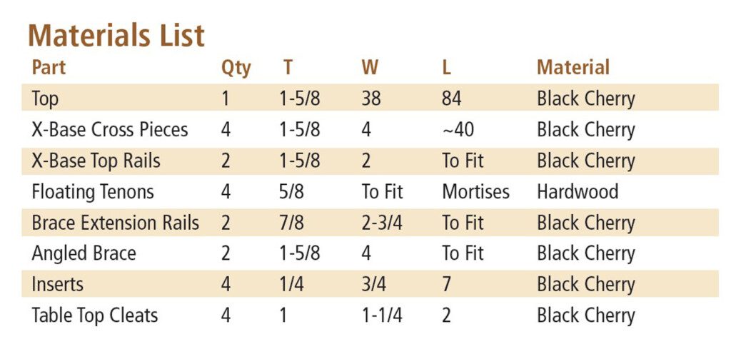

dining table drawing
dining table material list
