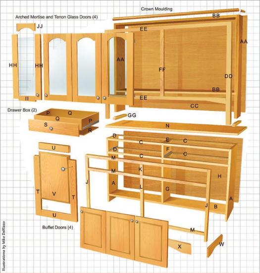

Building the Buffet

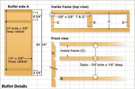

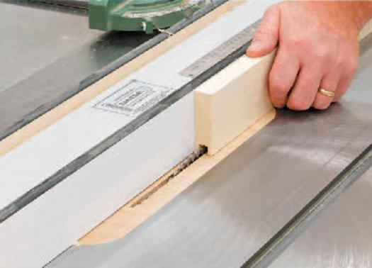

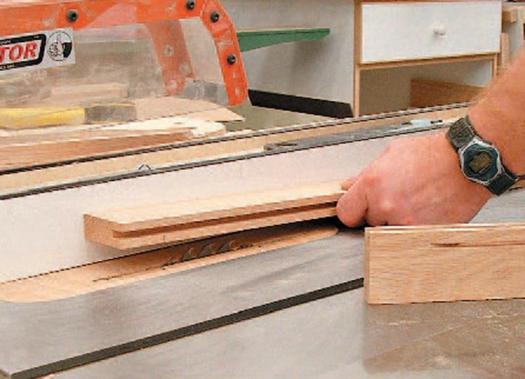

Begin by cutting two side panels (A) and mark them left and right. Then cut a ¼” x ⅜” rabbet on the inside back of each panel. Next cut 3 dadoes, ¾” x ⅜” on the inside faces of the panels. Follow the illustration for the cut locations on all the other parts. There is always a slight difference in thickness of veneer ply core, set the dado accordingly for a tight fit.

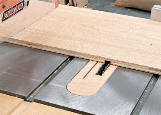

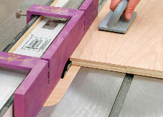

Cut the bottom shelf (B) and make a ¾” x ¼” dado in the center. You need to build a pair of inside frames (C, D and E) to match the size of bottom shelf (B). Cut a ⅜” x ⅜” groove on the long edge of (C). Cut matching ⅜” x ⅜” tongues at both ends of the 6 rails (D and E). Assemble the frame with glue brad nail.
Cut a dado ¾” x ¼” in the center of the top inside frame and the middle inside frame to fit the dividers (F and G). Cut parts (F) and (G) to size and dry fit all the parts of the carcase and clamp in place. Re-measure the dimensions for the backboard (H) and cut the backboard accurately as it will hold the carcase square when installed.

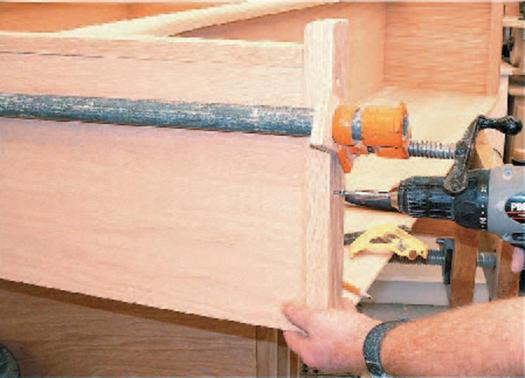

This is where an extra hand is useful. Glue all the parts, making sure they are flush at the front. Raise the clamp to provide enough space to slide in the backboard and tack it in place.

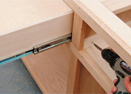

Attaching Drawer Slides
Because the drawers are only 16″ deep, I used full extension drawer slides for full access. Cut and install wood cleats straight back and flush to the side of face frame. Use leftover wood for the cleats, cutting them to fit your project. Glue and fasten with 1″ screws. Drill a pilot hole and countersink.

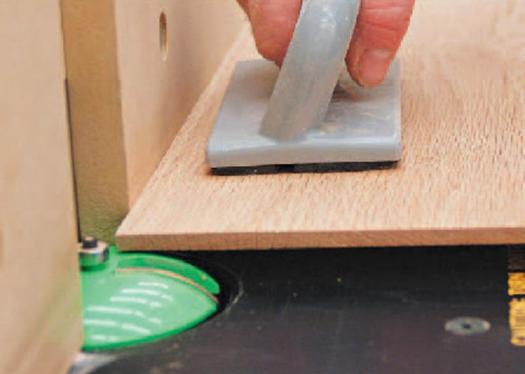

You can make the center raised panel using a panel-raising bit on a router table or with a table saw. Glue enough ¾” boards together to form a 11 ¼” x 19 ⅛” panel. Rout the face edges of the solid wood panel so that they are ¼” thick. Make slow, small cuts to avoid tear out and rough cuts. Sand the center panel and assemble the door. Use small strips of foam in the grooves to avoid rattling. Be sure the center panel is free to move as it will expand and contract with humidity. Glue the tenon and groove joints only, not the panel. Clamp securely making sure the door is square. Use ⅝” brad nail to secure the joint. Finally, round over the 4 sides of the door face with a ⅜” round over router bit.

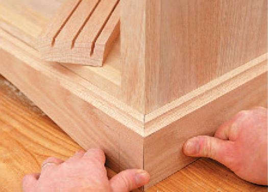

Install the Base Skirt
Cut and install the base skirt on the front and both sides. The three boards are joined at the corner with 45º mitres. Use glue and 1 ¼” screws from the inside of the cabinets to secure the boards. The top edge of the 3″ skirt is decorated with a cove router bit to match existing furniture.
Building the Hutch
Just like the buffet, the hutch is constructed of ¾” oak plywood, with solid oak face frames, so the assembly steps are similar.

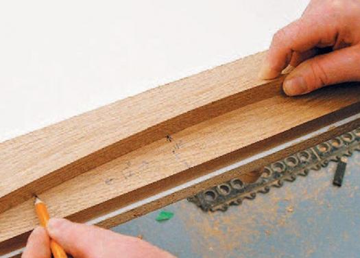

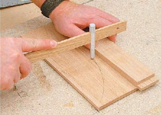

Cut the five pieces of the face frame, 2 stiles, 1 centre stile and 2 rails. To create the arch in the bottom rail, mark points that are 2″ in from the end of the board, and another point that is 1 ¼” from the bottom and 12″ from the end. Bend a thin strip of wood and draw the arc.

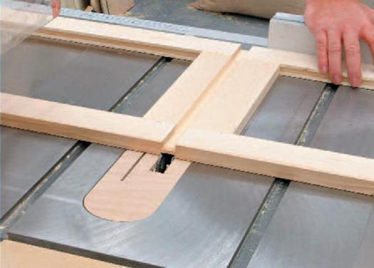

Each stile and rail needs a ¼” x ½” groove, centered on the edge. Create a ½” rabbet by cutting the back side of the bottom rail. Keep the small sticks that are created, as they will be used to secure the glass in the door. The stiles are cut the same way, except that we will need to plunge them into the saw blade leaving 1 ½” of the groove uncut at both ends. This will leave a 1 ½” mortise at each end of the stile for the rail tenon. To form the arch on the 4″ top rail, I used an adjustable yardstick compass. The arc has a 6 ½” radius. This leaves 2″ of wood at the top and around ¾” on each side of the rail.

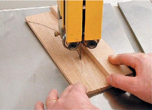

Cut the arch on the band saw, then assemble the door with glue and brad nails. To install the door we used euro hinges with face frame plates. This requires you to drill a 35 mm hole in the frame. Follow the manufacturer specifications for your installation measurements. We used 3mm glass and secured it with the rounded over oak strips we put aside earlier. You can drill the holes for the doorknobs freehand, build a template out of plywood, or use a commercially available drilling guide.

Cut a rabbet on the side panels
Cut a dado in the center of the bottom shelf
Cut a groove on the long edge of the inside frame
Cut a dado for the dividers
Install cleats for drawer slides
Rout the center raised panel
Install the base skirt
Draw the arc on the bottom rail

Plunge cut the hutch door stiles

Cut the arches on the bandsaw
