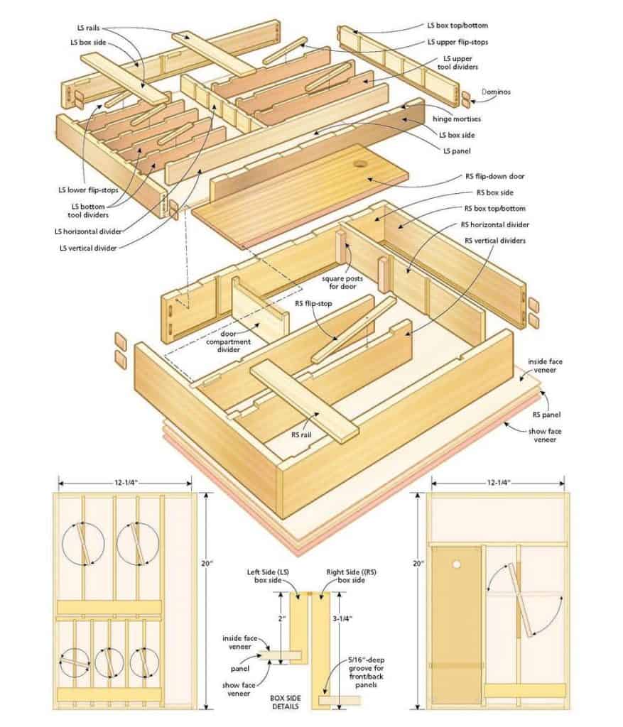

The box halves pivot open via four butt hinges. When travelling or, alternatively, not in use, they’re held closed with a pair of draw latches. Since this toolbox will hit the road, I added rails and flip-stops to the internal dividers to make sure everything stays in their respective places. The right half also has a section behind a flip-down door to house sharpening stones, gloves, scrapers and more.
I like to have the hardware on hand before getting too deep into a project to make sure it fits my design. I ordered the hardware from Lee Valley Tools, including two pairs of brass butt hinges 00D0201 and a pair of round draw latches 00S5551. I chose case handle 00S6220. Finally, for the flip-down door I ordered Lee Valley Tools’ hidden hinge pins 05H0201 in the 1/8″ size.
Keeping things light, I chose 1/2″ thick walls for the carcass, made the larger dividers 3/8″ thick and the smaller tool dividers 1/4″ thick. Joinery was kept simple, with slots and grooves cut on the router table. For the carcass joinery, I chose a pair of 4mm × 20mm Festool Dominos in each corner of the smaller left half and 6mm × 40mm Dominos for the bigger right side. Other joints, such as dowels or mortise and tenons, would work equally well on the box corners. Use the method that you’re comfortable with and have the tools for.

It’s much easier to design a box with a specific purpose by using the actual contents you plan to store to determine the size. Try different positions for tools or group the ones used together. When laying out the tools on your workbench, keep in mind that the back panels will need to be added to the overall depth. Take your time with this stage as the dimensions will be determined by this step. I grouped the thinner tools on the left side of the box and the bulkier, odd-shaped items on the right. For added accuracy, mill up pieces of scrap wood to size and confirm that everything fits. The final dimensions ended up being 13-1/4″ wide × 20″ long. The box is 2″ deep on the left and 3-1/4″ on the right.

Determining where to locate each tool is an important step. Generally speaking, a project like this needs to be as small as possible, though it’s just as important to be able to hold all the necessary tools in one toolbox. Der-Garabedian lays out the tools on a piece of material and records how much space is needed.

Illustration by Len Churchill
[illustrations_gallery]
