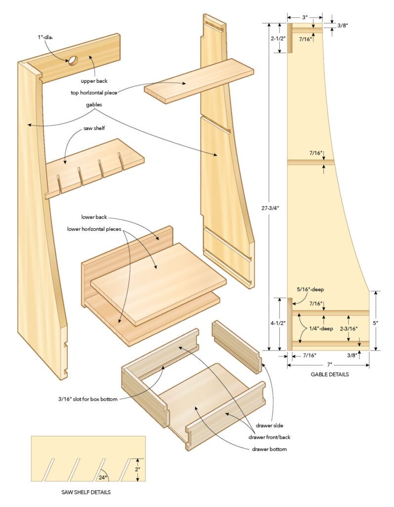

I wanted to have a stand that could sit on the end of my bench but could also be hung on a wall when I needed a clear top. I have a pair of veneer saws and some saw guides that could be housed in a drawer. I didn’t want anything that looked heavy or only had straight lines, nor resemble the Studley Toolbox. Something nice and simple.
After measuring my saws for both length and width I went to my local wood supplier and picked out a pre-milled piece of mahogany that was 8′ long by 7-1/2″ wide and 3/4″ thick. I also picked up a small piece of black limba for the drawer parts that I thought would add some contrast.
More milling
I don’t like using standard thicknesses for projects as 1/2″ and 3/4″ are what mass producers’ machines are set for. Changing dimensions by even 1/16″ will make the work more pleasing to the eye. For the sides of the stand I milled the pieces to 9/16″ thick by 7″ wide and 27-3/4″ long. These will be cut with a sweeping curve from 3″ at the top to the 7″ width just above the drawer. The other parts for the carcass were all milled to 7/16″ thick. Finally, the drawer parts were milled to 5/16″ thick except the bottom which I thinned down to 3/16″.
In keeping with the simple theme for the stand, I opted for grooves in the side pieces to hold the cross members. I left these pieces slightly wider than the listed dimensions as these would be trimmed after one of the dry-clamping runs. The grooves are easier to cut with the side pieces still in rectangular form rather than with the curve sliced out of the front.
Stops, stops and more stops
In order to make sure the cross pieces were perfectly horizontal, I used my crosscut sled and a pair of stops. I don’t have a dedicated sled for a dado stack, and since the grooves are only 7/16″ wide, I went with a cross cut blade and just incrementally moved the pieces between the stops. The top and bottom grooves start at 3/8″ in from their respective ends and I cut these in both pieces with this initial setup. All the grooves are 1/4″ deep. After taking a rough measurement of my longest saw I added the next groove 2-3/16″ from the top of the bottom grooves. This creates the space for the drawer.
Next, dry assemble the stand and centre your longest saw, and a small gap, in the opening. Mark the bottom of the handle and create another mark 7/16″ down. Cut this once more on the table saw using a pair of stops. Due to the length of the side pieces, I needed a bit more reach than the fence the crosscut sled provided. Using a stop shaped like an “L” did the trick.

Since one of the requirements of the stand was to be able to hang it on a wall, the backs needed to be inset into the sides. I used a rabbeting bit on the router to cut a stopped rabbet 7/16″ deep and 5/16″ high. To test my setup, I used the offcuts from the previous step. The top back piece is 2-1/2″ wide and the bottom is 4-1/2″ wide. The top also gets a 1″ hole drilled in the middle, but offset slightly to the bottom. Stop the rabbets 1/4″ shy of each width, as these will be squared up using a chisel.
After squaring the rabbets, dry fit the backs onto the carcass and butt the horizontal shelves to them — all except the middle one. The middle saw support shelf is flush with the back. Now trim the horizontal members to their final widths. Good designs don’t always have all of the pieces flush. I ended up leaving mine 1/4″ longer than the front of the sides.
An angled profile
If you have a lot of saws to house in your stand, you could fit them closely with slots straight in. However, I thought giving them a slightly angled profile, 24° in my case, was a pleasing change. Again, using one of the waste offcuts, lay out what works best for your saws and taste. The cuts, which reach 2″ from the front of the cross piece, are approximately 3/16″ wide, which is 1-1/2 times the width of a typical table saw blade.

Saw Slots
Although Der-Garabedian chose to make his saw slots in the saw shelf angled, there’s nothing wrong with cutting them perpendicular to the front edge of the saw shelf.
Saw Slots
