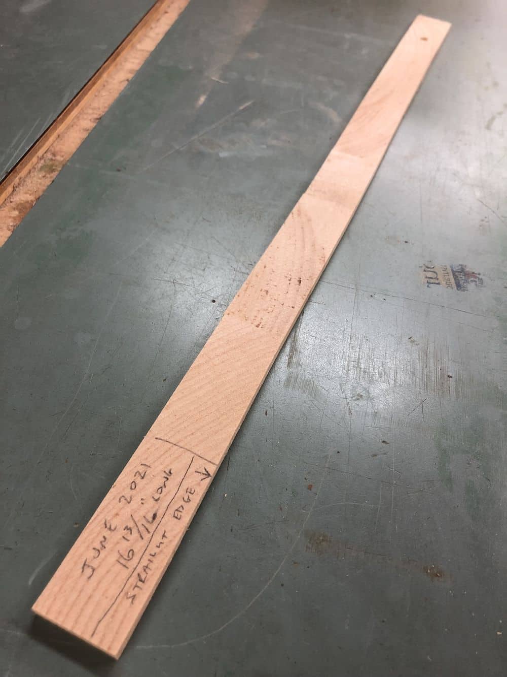

Keep Your OffcutsKeep Your Offcuts – I saved the offcut from a project a few years ago. One edge was perfectly straight at the time, and I recorded the overall width of the piece when it was cut. It’s been moving with the seasons ever since, and you can even see the two straight edges cup with the changes in the seasons. Now that it’s winter, and the humidity is low, this end grain offcut is 3/16” shorter than it was last June.
Regarding your comment about a solid wood joint that lived outdoors for the last 20 years still holding strong: I’m not surprised at all. Two main things are needed for that to happen: 1) a proper edge has to be machined on mating pieces; and 2) a waterproof adhesive needs to be used. These two components should produce a joint that lasts longer than the pieces of wood themselves, as wood will eventually rot when outdoors.

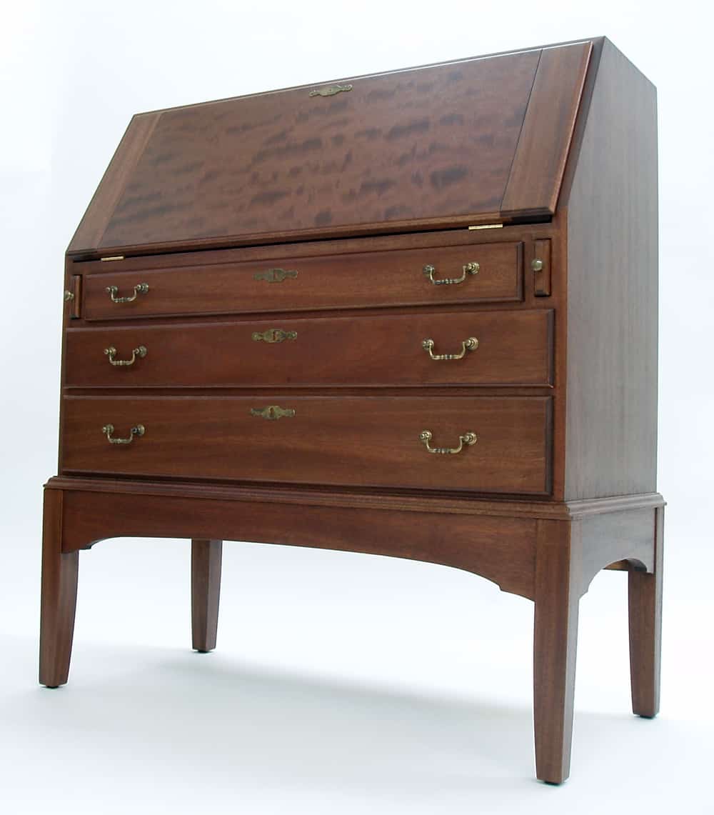

Mahogany Secretary Desk
Another example of how solid wood and veneered panels can come together to produce a piece of quality furniture. I made this mahogany secretary desk mostly of solid wood. The drop front is veneered plywood. The figure I added with the blistered mahogany comes through strongly, yet the panel is stable.

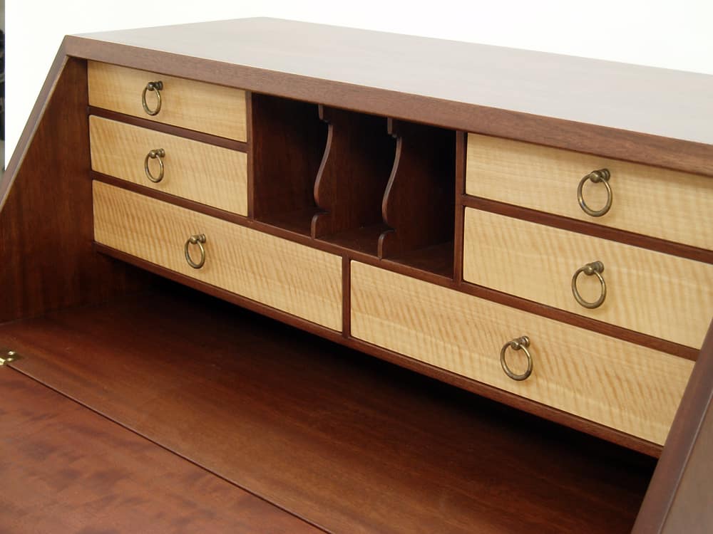

Desk Interior
The interior also includes a mix of solid and veneer. The drawer fronts are end matched curly anigre applied to solid drawer fronts.
Desk Interior
Keep Your Offcuts
I saved the offcut from a project a few years ago. One edge was perfectly straight at the time, and I recorded the overall width of the piece when it was cut. It's been moving with the seasons ever since, and you can even see the two straight edges cup with the changes in the seasons.
Keep Your Offcuts

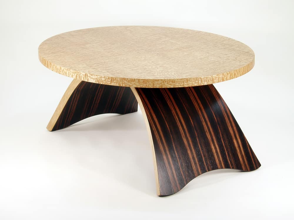

'Arc Coffee Table'
The ebony base was pressed up with wiggle plywood, then solid white ash headers were adhered to the sides and ends of the base for protection and aesthetics. Constructing this base would be impossible with solid wood.
Arc Coffee Table

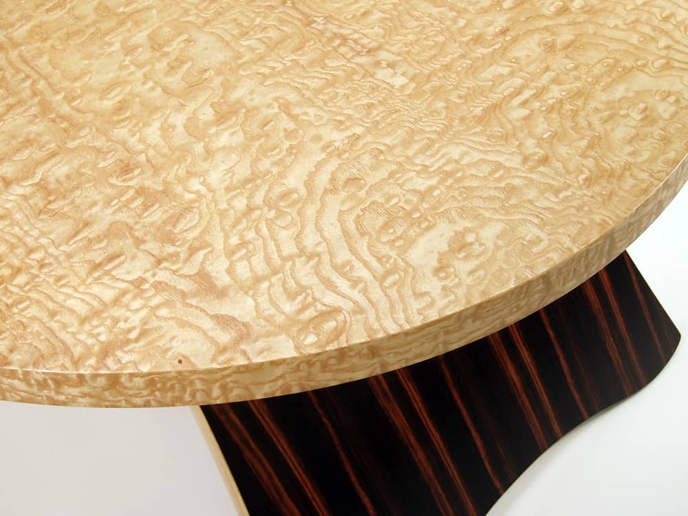

Tamo Ash Veneer
The tamo ash top is highly figured wood that is mostly found in veneer form. The plywood core offers a stable and strong substrate for the veneer.
Tamo Ash Veneer

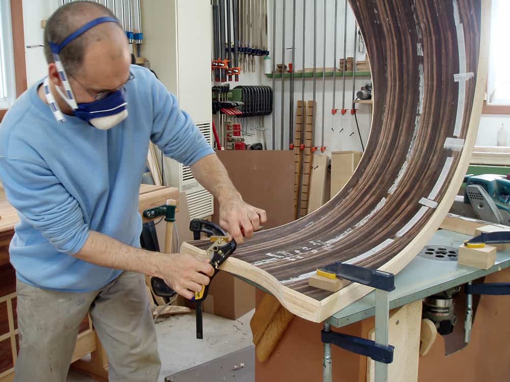

Add Some Shape
Once the solid ash headers were attached, I shaped them with a spokeshave and other tools.
Add Some Shape
