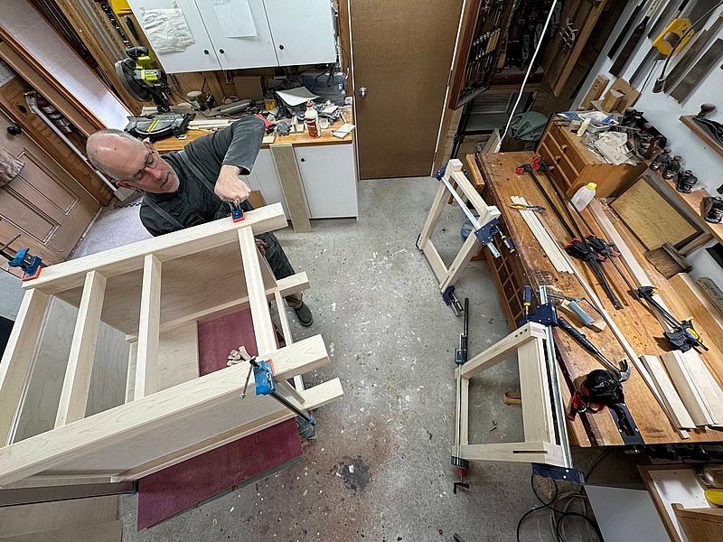

Here's one of the cabinets that’s getting assembled with Festool Dominos and a 90% work, 10% enjoyment ratio.
