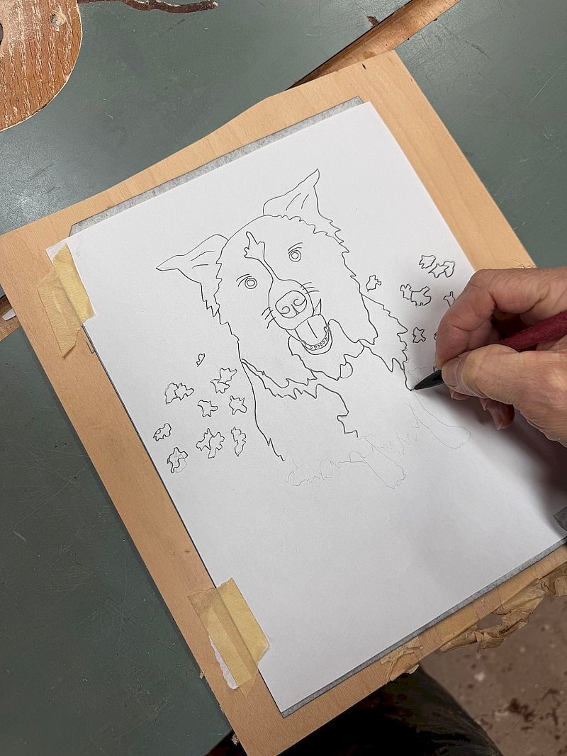

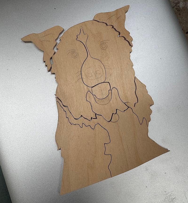

In both cases, I brought the image up on my laptop and zoomed in until I had the dog at the actual size I wanted the portrait to be. I taped a piece of blank paper to my screen and lightly sketched the dog onto the paper. At the shop, I used carbon paper to transfer that design to thin plywood, then got to work on making what amounts to essentially a lot of weirdly shaped puzzle pieces.

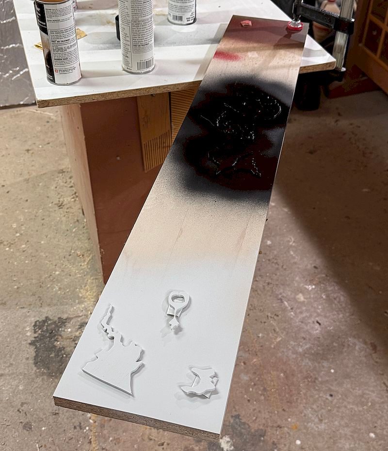

I used the scroll saw to cut the parts out. The trick was keeping all the parts in some sort of vague order, so it wouldn’t be a nightmare putting them all back together again. I marked all their undersides. When complete, I quickly sanded the sharp edges and grouped them into paint colours. Some of these parts were large enough to stay put while I sprayed them with an aerosol paint can, but most were too small. I taped them to a board so I could make a few passes with each paint can and colour all the parts accordingly.

Carbon Copy
Here, I'm transferring the original sketch to the plywood, with carbon paper. I eventually decided to do away with the leaves, scattered around the background. Not only would they take a lot of time to do, but they might not come across as well as I hope in this project.

Puzzle Pieces

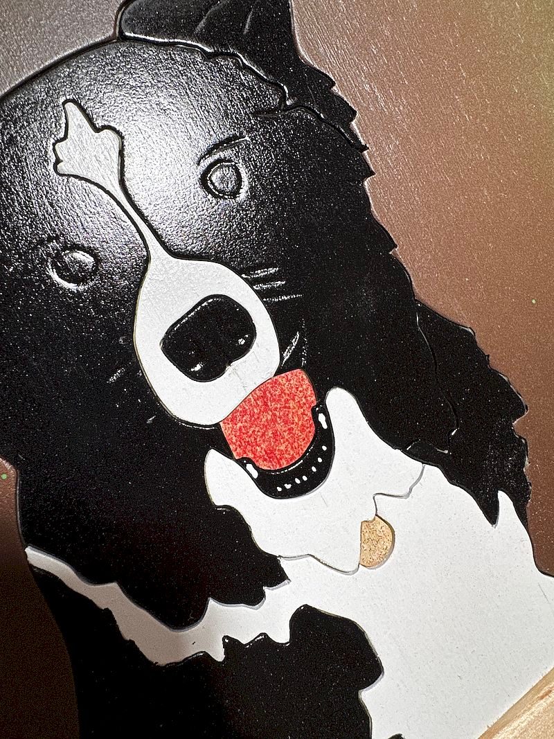

I guess I could have just ended this project here and called it a jigsaw puzzle. I eventually decided to cut out the nose too, then I added some grooves for the eyes, whiskers and some other details with a sharp carving tool.

Apply a Finish
I taped most of the parts to a scrap board so I could spray paint them.

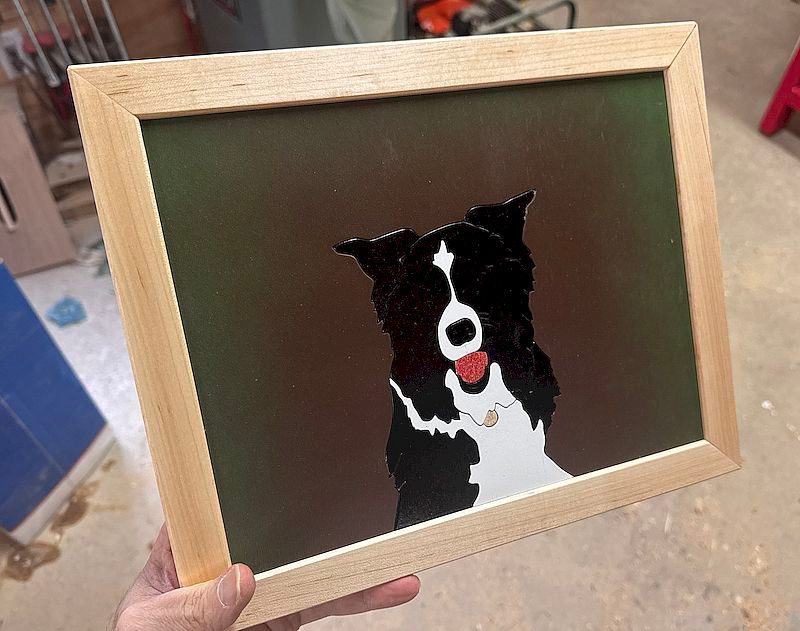

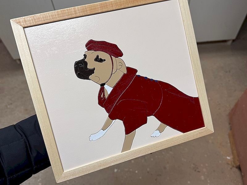

"Jimmy"
Here's the first portrait, ready to be gift wrapped.

The Details
You can easily see the carved details with some raking light.

"Ollie"
This is the dog portrait I made for my brother and his partner.
"Ollie"
Sunday Best
Here's the photograph I worked from.
Sunday Best
