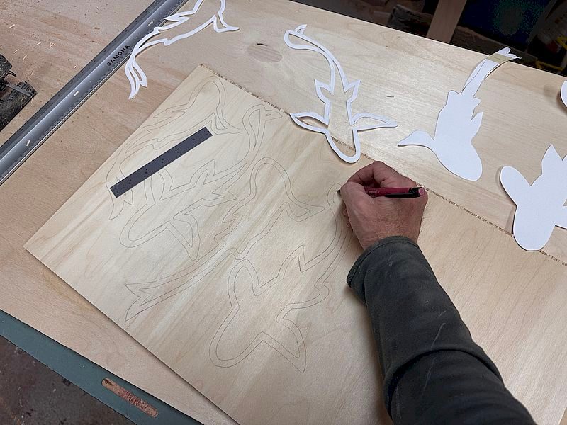

The first step was to cut out enough fish for the project. I used the paper templates to trace koi outlines onto 3/8″ thick Baltic birch, then cut them on the scroll saw.

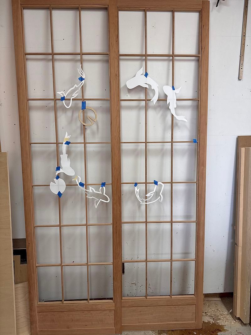

Positioning them on the screens wasn’t easy. Because the screens aren’t flat, I laid the screens flat on the table saw’s outfeed surface and moved them around. I sometimes had to support the ends of the fish with something to keep them parallel with the surface of the screen so I could see what the overall look was. After about two dozen tries, I came up with something I liked.

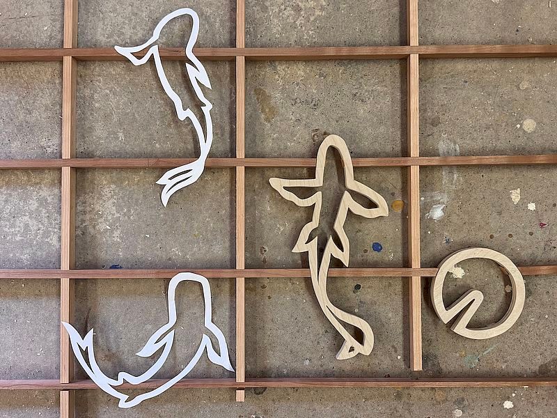

Many small (curved) half-lap joints
My current plan is to machine a half-lap joint in the face of the kumiko to allow the Baltic birch fish to sit in the kumiko by about 1/4″. This will leave the faces of the fish about 1/8″ proud of the kumiko.
The first challenge is how to create these half-lap joints. Half-lap joints are typically cut at, or fairly close to, 90° to the edge of the workpiece. On top of that, the cheeks of a half-lap joint are typically straight. In the case of these screens, neither of these two things are true. Since the edges of the fish are all curved, and they meet the kumiko at pretty much any angle, these are certainly unique half-laps.
Because of this challenge, a handsaw can’t be used to cut these notches. I’m considering a router, equipped with a small diameter straight bit. The small radius (about 1/4″) will allow me to get into some curved nooks and crannies, while the depth of the bit can be set to give me notches of consistent depths. I think I’ll have to add a larger plywood base to the bottom of the router, as the router will otherwise be almost impossible to keep at a right angle to the faces of the kumiko. The thing that makes this extra tricky is that the outer 1-3/4″ wide frame of the screens is set proud 1/8″ from the faces of the kumiko. I will have to cut the notches away from the outer frame first, then adjust the depth of the router bit to give me the same depth, even though the router will be 1/8″ higher.
If the router approach doesn’t work, I might turn to hand tools. Start with a handsaw to set the rough width of the notches, remove some of the waste between the notches, then use some curved carving gouges to shape the cheeks to fit the curved edges of the fish. I feel like this will be a lot more finicky than I’m hoping for though.

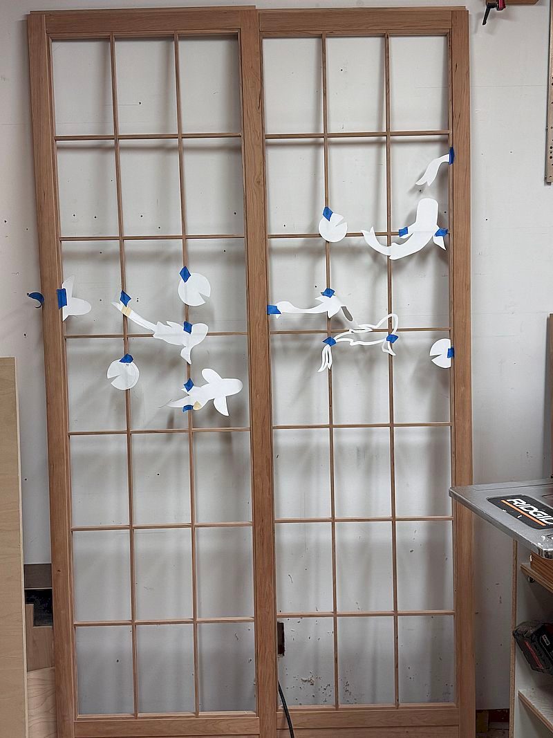

With the basic structure of the two shoji screens complete, the only thing left is to add the koi motif to the kumiko. This fish motif is in a circular pattern.
Another Option
Although it's slightly hard to tell, the pattern of this design is from centre on the left towards the upper right corner.
Attaching the Fish
Here, I'm experimenting with how to fix the fish to the kumiko.

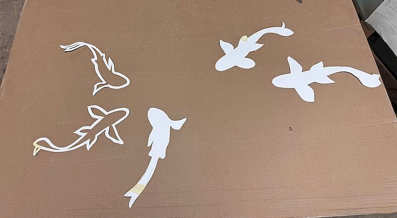

Easy Adjust
Paper designs are quick and easy to make. They're also easy to adjust, in relation to each other, in order to figure out a design that's pleasing to the eye.

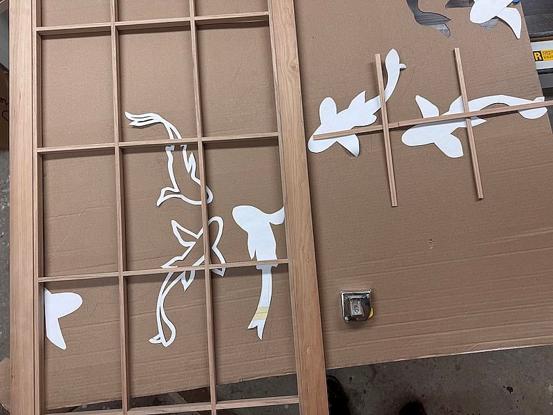

The Screen
Not only does the fish design have to look good in relation to the other fish, but the fish also have to fit onto the screen properly. Laying the screen over the paper fish allows me to see how the fish relate to the screen members.
Making Fish
I use the paper templates to draw the fish onto the Baltic birch plywood. A scroll saw will allow me to get into the tight curves of these plywood fish
Placing the Fish
Using these three fish, I'm trying to create a focal point for the pair of shoji screens. The other fish on the screens will also be heading towards this point.
